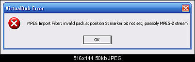

  1. I don't even know where to begin on asking questions here. Is it too much to expect that there would be a software out there that you can open a variety of video formats with and then choose 'deinterlace' and it does the job? Then, of course, there can be all kinds of options to refine the deinterlacing process. So, after much much reading I decide to just begin with what everyone refers to as the most basic software, Virtualdub. Start somewhere and then build and improve on what I know, right? Well, to begin with I can't load any original uneditted files into Virtualdub or I get this error:

    Your source video may be corrupted -- that's not VirtualDub's fault.
  3. Get the MPEG source plugin for VirtualDub. VirtualDub has problems with interlaced MPEG but it's something to get you started. Or use VirtualDubMod instead of VirtualDub. It handles interlaced MPEG better and doesn't need the source plugin. But since it's based on an older build of VirtualDub it doesn't have the newest deinterlacing options.

  7. Okay I just cut and paste the mpeg source plugin into the 'plugins' folder for virtualdub. Still doesn't load mpeg files - except mpeg1 files.
  8. Check your file with MediaInfo. It will tell you what container and what codecs are used.
    Did you exit VirtualDub and restart it? It only checks for plugins when it starts up. So if you had VirtualDub open before you installed the MPEG2 plugin VirtualDub wouldn't see it until you restarted the program. Can you open the M2v file I uploaded for smurf?
