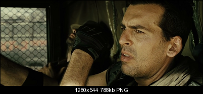

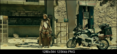

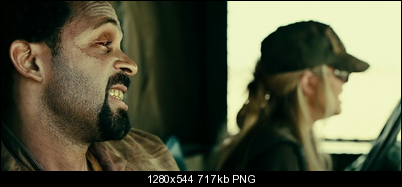

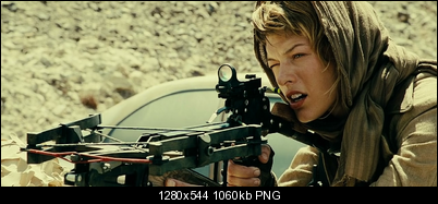

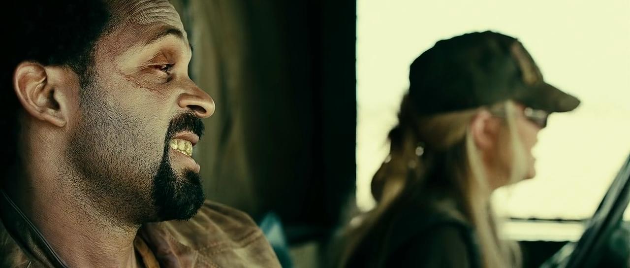

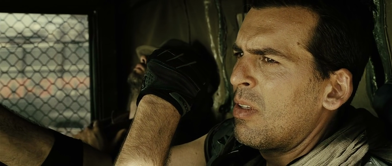

  8. What would be good settings for a 720p or 1080p compression at a bitrate of 2337KB/s? I know I asked you this before, but can you just tell me what the command line for just the x264 would look like for this?
    Writing library                  : x264 core 80 r1376M 3feaec2
    Encoding settings                : cabac=1 / ref=8 / deblock=1:-2:-2 / analyse=0x3:0x113 / me=umh / subme=9 / psy=1 / psy_rd=0.2:0.0 / mixed_ref=1 / me_range=32 / chroma_me=1 / trellis=2 / 8x8dct=1 / cqm=0 / deadzone=21,11 / fast_pskip=0 / chroma_qp_offset=-1 / threads=3 / sliced_threads=0 / slices=2 / nr=0 / decimate=0 / mbaff=0 / constrained_intra=0 / bframes=6 / b_pyramid=2 / b_adapt=2 / b_bias=0 / direct=1 / wpredb=1 / wpredp=2 / keyint=250 / keyint_min=25 / scenecut=42 / rc_lookahead=42 / rc=2pass / mbtree=1 / bitrate=1933 / ratetol=1.0 / qcomp=0.60 / qpmin=10 / qpmax=51 / qpstep=4 / cplxblur=20.0 / qblur=0.5 / ip_ratio=1.40 / aq=1:1.00
    Here are the screen shots. These are the original ones that came with the movie.

    And if you could step it down so it could be almost the same quality but with a bitrate of 2337KB/s, so like maybe changing the ref or anything else to make it faster, but instead for that bitrate and this quality, for the bitrate that I want for pretty much the same quality.
    If what I am asking is to much, that is fine just tell me, and if you could then just tell me what the command line should look like for those settings at that bitrate, that would do too, I will just change the bitrate instead of changing the settings.
    I am going to use MeGUI.
    If you guys don't have the time to help me with this, I can wait. Just take your time, and if you can, answer this when you have the time and there are not more important questions then this.
    Thanks. I really appreciate the help.
    Metroidn1f
  9. Not possible. You're not going be able to cut the bitrate from ~5Mb/s in half and expect it to look good, not matter what the filtering or settings used.
    The difference between using the normal preset and some thing much more intense like "veryslow" might only get you 5-10% bitrate savings for the same "quality" level , as measured by PNSR or SSIM , and it takes about 5x longer
    If you have the original source, you can make it look as good as the sample video if you used the same settings and filters
    If you plan on low bitrate encodes, filtering (e.g. denoising with avisynth filters) is way more important than encoding settings
