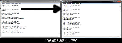

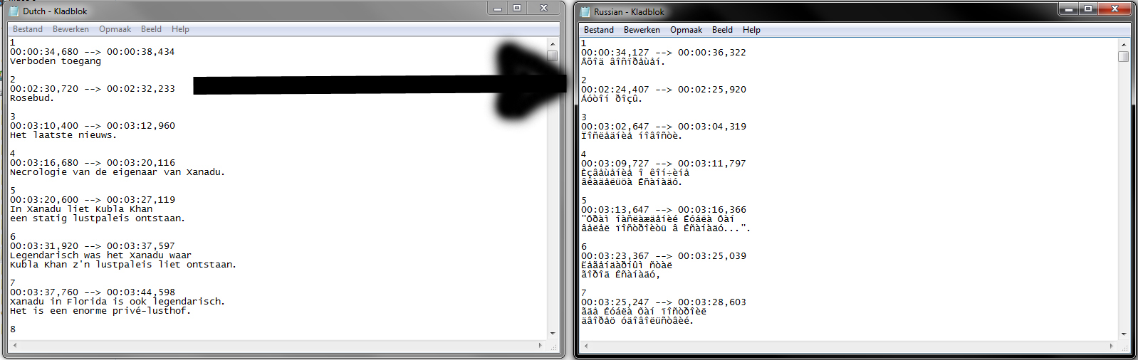

    Is it possible to replace the subtitle timings?
    I have a dutch.srt subtitle which is in-sync, but also a russian subtitle wich is not in-sync.
    So the timings of the dutch subtitle is correct, can I put the timings of the dutch sub into the russian sub, without affecting the text? I think is a simple job, but I cant find any tool.

  2. Member Abas-Avara's Avatar
    Aug 2009
    Azerbaijan
    Image explaining

  3. Member netmask56's Avatar
    Sep 2005
    Sydney, Australia
    Have you tried Subtitle Workshop ?
  4. Member Abas-Avara's Avatar
    Aug 2009
    Azerbaijan
    Thanks!
    I've tried it earlier, but couldnt find the option.
    Now I've find it, I had to go to edit-timings-read timings from file
    Thanks again
