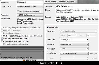

    I don't have Premiere Pro here but I can explain generally. Premiere should "smart render" (no recode) for unprocessed DV frames if set properly. Frames that are processed normally are decoded to RGB then encoded on export back to export format (DV)
    Assuming "NTSC" since you don't ID your location ...
    First set your project to DV-Wide 720x480, 29.97, lower field first
    Import the DV files to the timeline. Check that file properties (right click) including stills match project format.
    There should only be render lines above your stills and transitions.

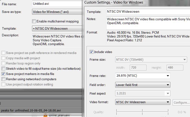

    Now here is where something went wrong in your second picture.
    Under export make sure DV-AVI (Wide) is selected and that properties match the project format.
    Here is how it looks in Vegas. Premiere should be similar.

  4. I Googled and it seems as though "Smart Rendering" only applies to MPEG streams, not AVI.
    PP smart renders DV-AVI specifically, but not necessarily all types of video codecs within AVI containers (you might have DivX or Xvid in AVI container for example - these are not smart rendered. AVI can hold 100's of different formats)
    The problem as EdDV pointed out, is your mismatched sequence settings.
    If there is a red renderbar , it means PP is rendering everything. If there is none, those segments will be passed through. You will notice on the crossfades and effects, there will be red over those sections, because those sections need to be re-encoded. If you have mismatched sequence or export settings, the entire thing will be re-encoded
