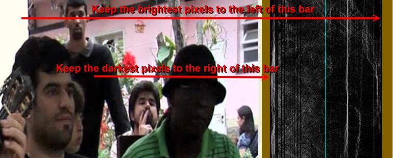

  11. I recommend you use VideoScope() or the internal Histogram() filter to see the levels graphically.
    That sounds interesting, but will I understand what they show me?

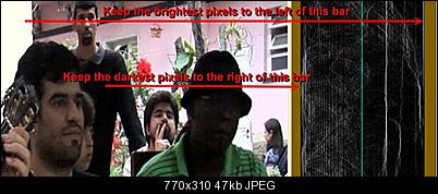

  14. ImageSource("contrast#1.jpg", start=0, end=23, fps=23.976)
    Crop(0,0,-4,-3) #image must be at least mod8 for DeBlock
    ConvertToYV12() # must be YV12 for DeBlock
    v2=Deblock().Levels(11,1.4,255,0,249, coring=false).Tweak(sat=1.2)
    Interleave(last,v2) # easy before/after comparison
    Histogram()
    All I had was your JPG image so I had to DeBlock() first. Deblocking is a normal part of h.264 decoding so you shouldn't need to deblock your video source. Levels() is very sensitive with a gamma adjustment this large so you'll probably have to fine tune the values when working with the video. With Histogram() keep the video out of the amber bars (black level at the left, bright level at the right).
