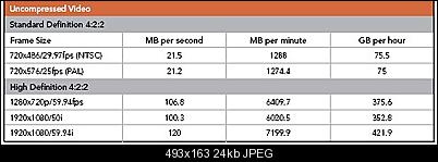

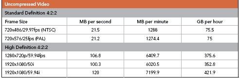

    Premiere won't see it. You capture with enclosed software then import the resulting file into Premiere.
    From BM Intensity Brochure

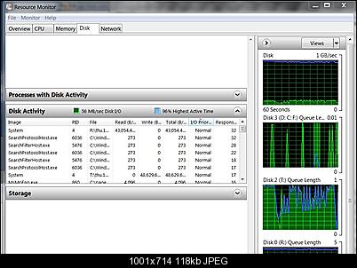

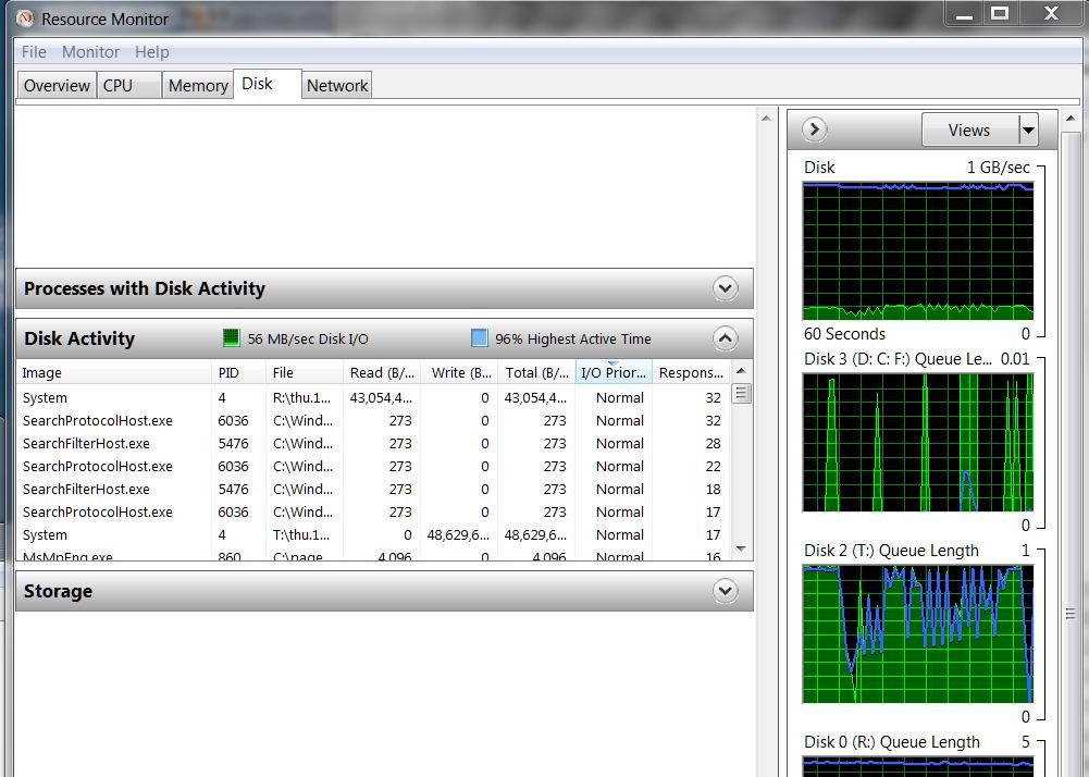

    There is a built in Disk monitor in Win7 Task Manager (see Resource Monitor). You should also track memory use.
    The CPU shouldn't be doing much during uncompressed capture.
