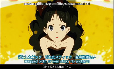

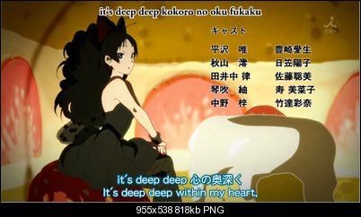

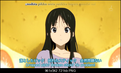

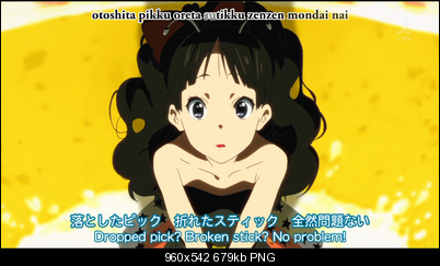

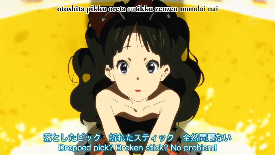

  1. I'm trying to encode any x264 video to x264 to any other container
    it seems the result i get is weird transparent vertical lines, and different contrast changing in different scenes,
    what would be the problem? I'm using K-lite mega codec 6.0.4, Avisynth 2.5.8 + MeGUI
    I choose a short video from Chihiro to test encode, (it's anamorphic encoded)
    my avisynth script:
    # Set DAR in encoder to 16 : 9. The following line is for automatic signalling
    global MeGUI_darx = 16
    global MeGUI_dary = 9
    DirectShowSource("C:\Downloads\Completed\[Chihiro]_K-On!!_[1440x1080_H.264_AAC]\[Chihiro]_K-On!!_-_ED_[1440x1080_H.264_AAC][25FF6F0C].mkv", fps=23.976, audio=false, convertfps=true)
    #deinterlace
    #crop
    LanczosResize(1440,1080) # Lanczos (Sharp)
    #denoise
    ConvertToYV12()

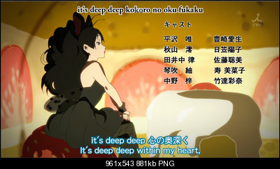

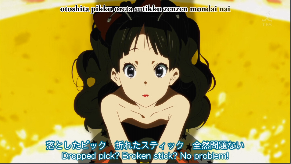

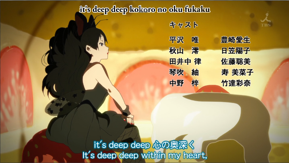

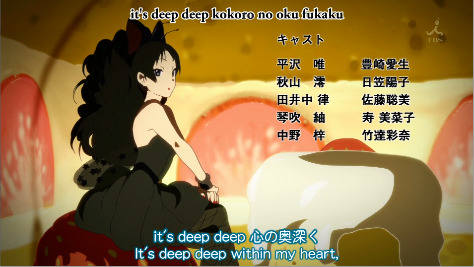

    I've problem to type after attached images,
    please use image name as refer,
    testvidori1-3 = original video
    testvidencd1-3 = video after encoded
    from these image, you can see the differences...
    -visible transparent vertical lines (you can see it clear at first 2 images at her black dress,this lines barely visible at other brighter area too)
    -different contrast changing in different scenes
    any solution ?

  2. Could be directshow issues and codec pack issues; try another source filter like ffmpegsource2() instead of directshowsource()
    The 1st & 2nd series screenshots aren't even of the same frame, nor are they the same size. How are you taking screenshots?
    Why are you encoding an x264 encode to x264 ?? Waste of time ?

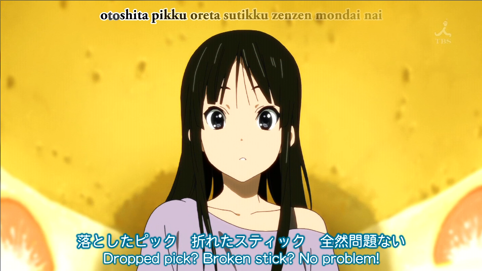

  3. Hi, thanks for reply,
    the 2nd image is later than 1st image few frames(transparent vertical lines visible on black dress girl, and most other scenes) i couldn't cap it in mpc for some reason, i use print screen to cap instead,
    it's not only x264 to x264 having the same problem, I choose this anime video because it clearly shows the problem than other vids, I was trying to encode from FRAPS avi (or other format) to x264, having the same problem,

  4. The problem isn't in you AviSynth script. It's probably in the way you view the videos and the graphics cards drivers.
    You can't compare two videos at the same time in two different players. The graphics card has a "video overlay" feature that can only be used by one program at a time. Video overlay has its own proc amp (brightness, contrast, saturation, etc.) controls. If you play two videos at the same time the first player gets video overlay, the second doesn't. The two players will usually look different, even if they are playing exactly the same file. Make sure this isn't the source of the differences in brightness and contrast.
    The brightness and contrast differences you see are almost exactly the difference between the rec.601 and pc.601 YUV to RGB conversion matrices (more contrast in rec.601). This could be a matter of what program you used to grab the frames.
    The second issue, the "vertical lines" in what should be a solid color area, looks like a known bug in the way some graphics drivers process video. You can try selecting different output drivers in your player. Also try updating to the latest driver for your graphics card, or disabling the graphics driver's video filtering.

  8. It's probably a playback issue. I just did a test encode with your sample and it looks the same (no color/levels shift, no vertical bars)
    Try some other playback software, like MPCHC, or KMplayer, or SMplayer
    If you upload your encoded sample, we can help rule out if its some directshow issue on your system

  10. The encode looks fine; no color or levels shifts, no vertical lines. Very likely a playback problem, either with render or codec pack problems

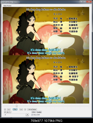

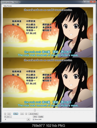

    You can prove it yourself. Stack them in avisynth, and play the avs, or open in vdub, or avsp
    e.g.
    a=ffmpegsource2("video1.mkv")
    b=ffmpegsource2("video2.mkv")
    stackvertical(a,b)
    #you might have to resize this if your too big for your monitor
    or you can open them in different tabs in avsp, and flip back & forth
    or you can interleave them (alternate frames from each encode)

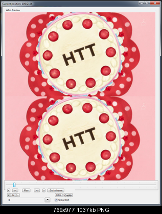

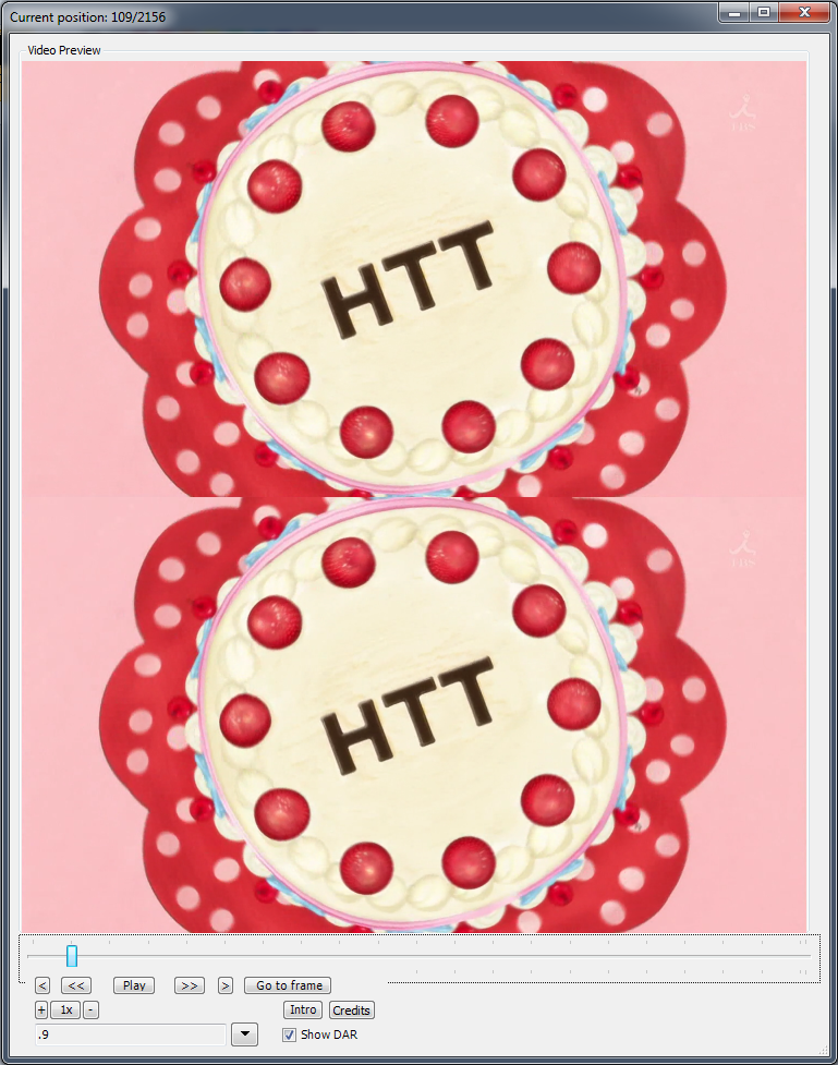

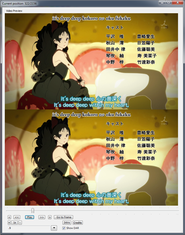

  11. it shows both videos are the same,
    well all the color/level shift and bar issues gone, thank you all for the help
    confirmed it's playback issue
    ignore the different brightness in two different screens, that preview player always like that
