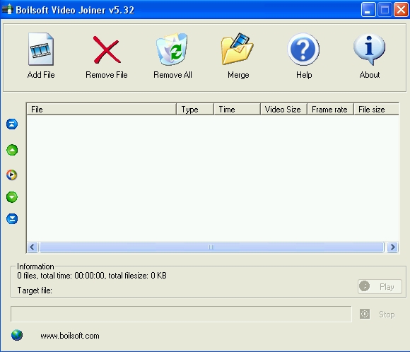

  4. Try the pay software Boilsoft Video Joiner. (see screenshot)
    It worked for me when Yamb did not work.
