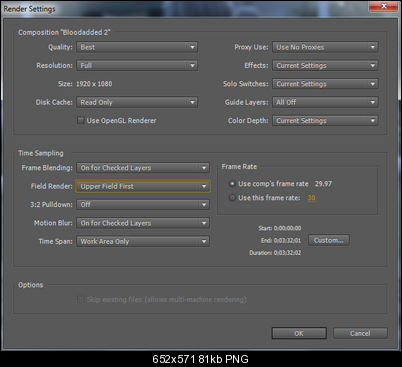

    I got a canon hfr10 camcorder and I shot a video in 60i. The video is 1920x1080 and has no interlace lines. I brought the footage into After Effects and edited it and I exported an H264 mp4 file that is 1920x1080. I selected upper field first in the render settings or whatever its called and the video runs smooth, but I can see interlace lines in the video especially when there is a lot of movement. I want the quality of my edited video to be identical to the original source footage. I'm not sure what to do about the interlace lines. Can anyone help me out?

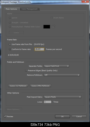

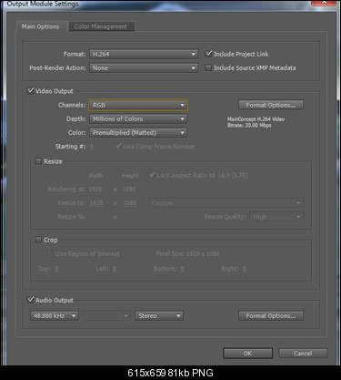

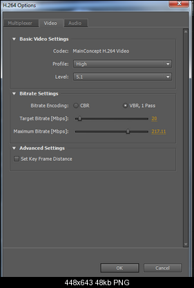

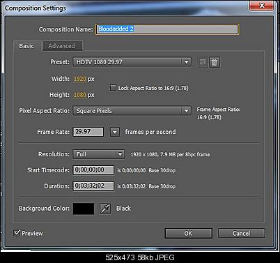

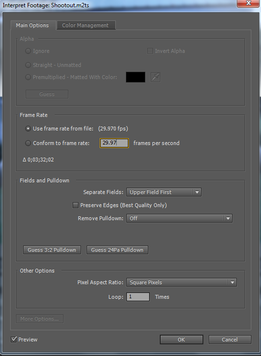

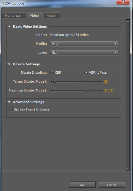

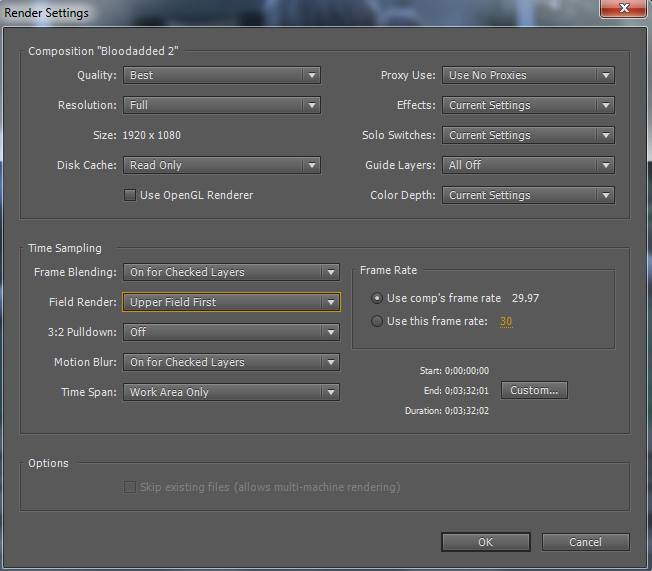

    And these are pictures of the settings I was using

Name:	render settings.png

Name:	output module settings for h264.png

Name:	interpret footage.png

    So.....does anyone know how I can get rid of the lines? Or what the cause was by looking at the pictures above?

    I don' t know about your failed export, when you render h.264 blu-ray there is a 2nd box where you have to choose upper field first instead of progressive. It's not showing that 2nd box in your screenshots. If you rendered as progressive, what you could be seeing is deinterlace artifacts.

    Ok. Here is the mediainfo on the failed export. The was from just selecting "h264" and not "h264 bluray", which I am about to try. I'll also do an uncompressed and tell you how it turned out. Looking at the mediainfo below, it says "progressive" by "scan type". Not sure why since I picked upperfield first...
