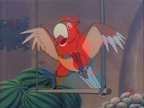

  22. Originally Posted by txporter View Post
    Sorry to take this off-topic, but how does one go about determining that the chroma channels are screwed up?
    Unblend it and have a look. I wouldn't use AlanHK's script though, as the framerate after unblending is meant to be 23.976/24fps. And you'll want to bob it before unblending it. The default SRestore setting is OK. Here's a sample frame:

  24. I just unblended it, cropped and resized it, using an AviSynth script, and played the script in MPC-HC. I went to a suitable frame and took a picture. I never actually reencoded it to anything. However, encoders, well most of them anyway, open AviSynth scripts just as they do video files. So, using these scripts you can reencode to any format you might like. Here's the script:
    Yadif(Mode=1)
    #TempGaussMC_beta1()#for use if you have all the time in the world
    #TempGaussmc_Beta1u(1,1,0,0,0,0,edimode="Nnedi2",S Vthin=0.0,pelsearch=1)#ditto
    Srestore()
    Crop(14,2,-8,-2)
    LanczosResize(480,360)

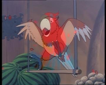

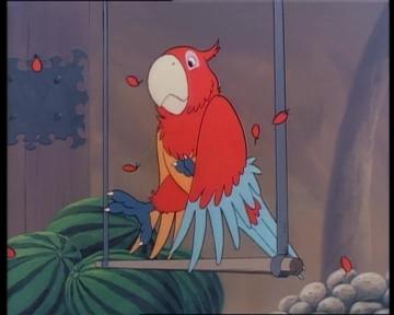

  28. The top and bottom fields in the frame from which manono's picture comes are from two different film frames. Each field should have the chroma channels from its respective film frame. But the bottom field somehow got a copy of the top fields chroma channels. So its colors are from the wrong film frame. Ie, if the luma channel of the bottom field is from frame N, the chroma channels are from frame N-1.
    film frame (N-1):
    bad field (luma from N, chroma from N-1):
    film frame (N):
