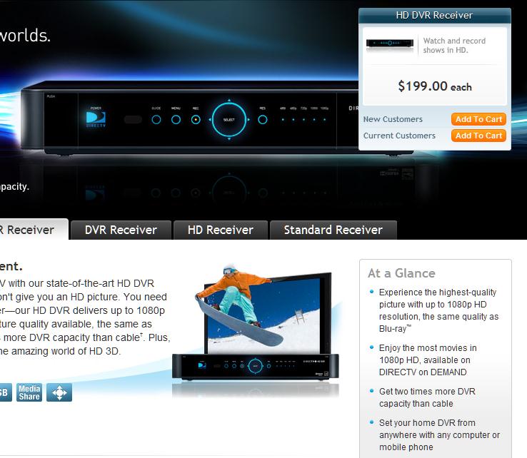

    Several things are required.
    1. Your HDTV would need to accept 1080p/24 fps over HDMI.

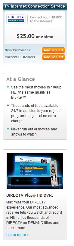

    2. You need their HD-DVR ($199) and connect it to your home broadband internet. There is an additional $25 charge to initiate Pay Per View service.
    They don't talk about bit rate but if they could actually deliver "Blu-Ray" quality live, that would require a sustained 20-35 Mb/s internet connection that only FIOS could deliver. Or, they are downloading non-real time so you have to wait for the movie to download before you can view it.
    My educated guess is they are not sending these at full Blu-Ray bit rate. If so it would be false advertising. You should be able to tell if the movies they are downloading consume >25GB of your DVR disk. My guess is they are using additional AVC compression to get down to 8-12GB or less which is far from Blu-Ray quality.

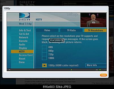

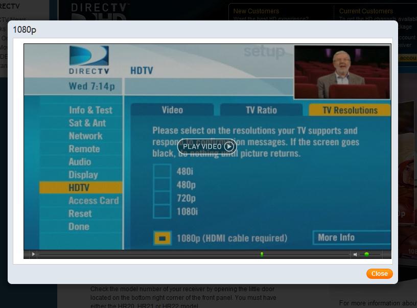

    3. You need to set the HDTV and box to 1080p/24. Tell us what it says under "More Info" in the setup menu.
