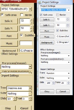

  8. Sounds like the DPI your of display is messing things up.
    Take a look at this screenshot comparison and see if your display looks somewhat familiar with the texts looking bad:
    Left: too high DPI(DPI=120) / Right: DPI=100%(DPI=96)
    https://forum.videohelp.com/threads/308016-converting-jpeg-into-video-format-for-slides...=1#post1897160
    If this is the case then try to change the DPI on your computer.

  9. OK....I totally forgot that I had changed the DPI when I got this new cpu earlier this year. Thanks so much. I set it to 100 and now the window opens all the way yeah!! I'll try working n the project tomorrow. Thanks again.
