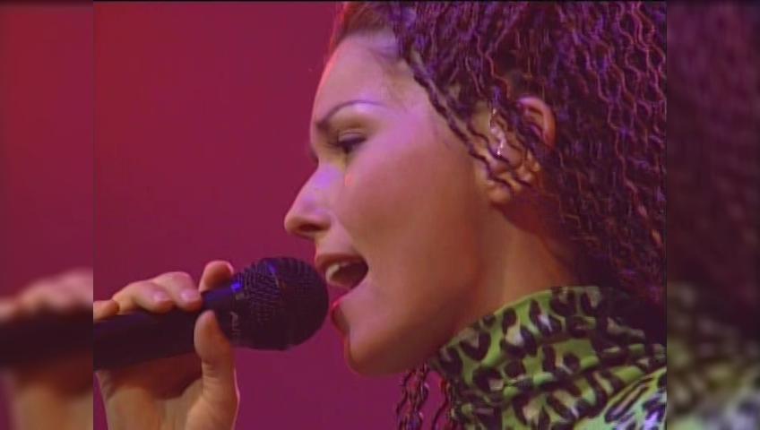

  2. You can do this with avisynth or practically any video editor. You just have to remember if you are working in square pixels or not (for web, it will be square pixel)
    The basic approach is to 1st resize in square pixel equivalents, then crop the video so you have the left side remaining (call this left) , crop so you have the right (call this right), and blur them, then assemble left, main, right
    An example of the code you might use in avsiynth
    MPEG2Source("video.d2v")
    LanczosResize(640,480)
    main=last
    left=main.crop(0,0,-536,0,true).averageblur(7,7,3,3,3)
    right=main.crop(536,0,0,0,true).averageblur(7,7,3,3,3)
    StackHorizontal(left, main, right)
    The 4:3 NTSC video displays as 640x480 on square pixel displays (like PC), the 16:9 NTSC equivalent would be about 848x480. 848-640 = 208, or 104 for each side. 640-104 = 536 which is the crop value
    Personally, I think black bars looks far better, and more professional

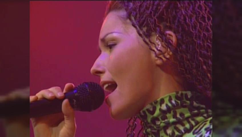

    Quite agree - I'm beginning to see this used on Spanish TV when showing 4:3 clips during a 16:9 broadcast, and to my eyes it looks awful.
    You can reduce the levels of the background to make it less intrusive, eg.
    left=main.crop(0,0,-536,0,true).averageblur(7,7,3,3,3).Levels(16,1.0,235,16,128)
    right=main.crop(536,0,0,0,true).averageblur(7,7,3,3,3).Levels(16,1.0,235,16,128)
    Note also that averageblur is not a built-in Avisynth filter; a separate plugin is needed.
    If using another editor (without stacking capabilities), it could be done by overlaying the 4:3 image centrally on a stretched and blurred copy of itself, equivalent to the Avisynth code:
    main=last
    BilinearResize(848,480).averageblur(7,7,3,3,3).Levels(16,1.0,235,16,128)
    Overlay(main, 104, 0)

    Jul 2009
    Spain
    Rather than blurring use BilinearResize() twice -- once to a small image, then to a larger background image, then overlay the original in the middle.
    Here's the result, also with levels adjustment, applied to poisondeathray's image using:
    main=last
    BilinearResize(80,60).BilinearResize(848,480).Levels(16,1.0,235, 16,128)

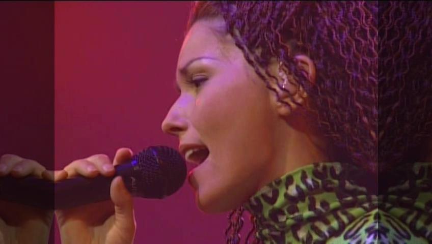

  15. Originally Posted by jr87 View Post
    well since you don't think this technique is good. What are my options? I really do not like black side bars, but I'm open to ideas. Thanks.
    Black bars is my favorite (or some decorative still image, if appropriate). Maybe mirror image the edges?
    Just tried it:
    Not too bad in a still frame but it's terrible in motion.
