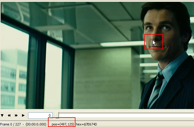

  3. 1) easy case & free - if you know how to use avisynth, you can point your cursor on a frame and avsp will report the coordinates. You can't play (only frame by frame) , and it won't export data. I appended an example screenshot to demonstrate
  4. filmboss80: my intentions are to feed the coordinates/frames/timestamps into another tool for a separate project I am working on. I wanted to see what tools there are out there at which price points. Free would be best, under $500 would be fine. Under $1000 would be acceptable. Anything over $1000 I would probably build the tool myself using c# and the directx library.
    poinsondeathray: Thanks. I will give avisynth a try. The easy case will definitely get me where I need to be for the moment. I will check it out over the weekend.
