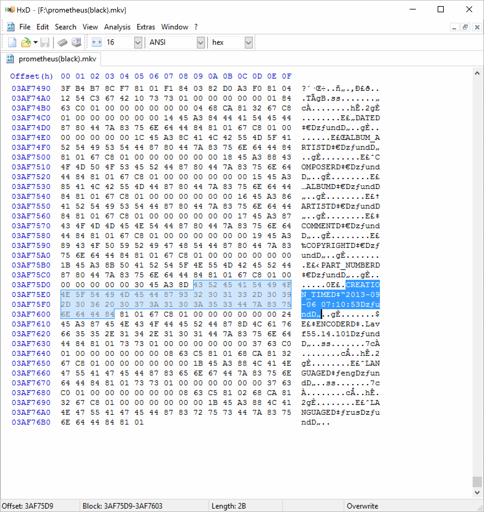

  13. I'd like to learn how to edit the HEX myself.
    Fair enough, but where is the problem?
    With a hex editor it's straight forward for me:
    • start the hex editor (for example HxD)
    • go to the end of the file and look for CREATION_TIMED (alternatively search for CREATION_TIMED)
    • edit the date shortly behind that entry
    • save file
    -> nothing magic, no extended knowledge of the mkv structure or similar stuff required

  14. Interesting. I've looked at half a dozen .mkvs that I have and have only found CREATION_TIMED in 2 of them. I've used a few different applications to encode them over the years. I wonder if they've used different file format standards.
