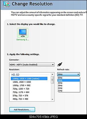

    Right, I forgot.
    None of my monitors or HDTV sets will accept 23.976p. I'd expect a 23.976 desktop to flicker.
