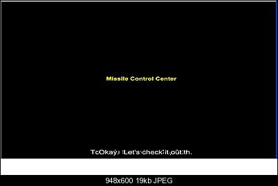

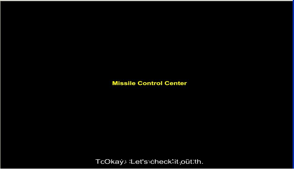

    Aegisub works, but when the *.avs file is inserted into VDub, both the Blankclip and the Aegisub subtitles are jumbled together and out of synch, even though I adjusted them both just right. See my code and the end result.

    See the end result:

    Question:
    1. How do keep the Aegisub subtitles from interfering with my Blankclip subtitles?
    2. How do I make the Aegisub subtitles in synch when playing/encoding in VDub?
  6. Originally Posted by PapaDmitry View Post
    Question:
    1. Raise one or the other, perhaps using a different color.
    2. I think you changed the length with your Blank Clips. Extract the audio from the final version and use that to synch the subs.

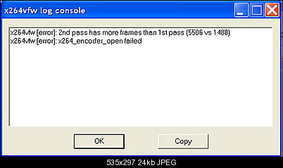

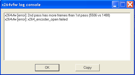

    I try multipass render with x264vfw and VDub gives me this error message. VDub loads the video and even plays it, but stops rendering 1/2 way through the job.
    It used to work earlier without Aegisub. It managed to render once actually, but the rendered file was poor quality: jerky, skipped frames, repeated frames, subtitles not aligned with video. Does this have to do with insuficient resources: Pentium 4 3.2 GHz, 3.5 Gb RAM? I noticed a significant VDub performance drop after I began using Aegisub.
