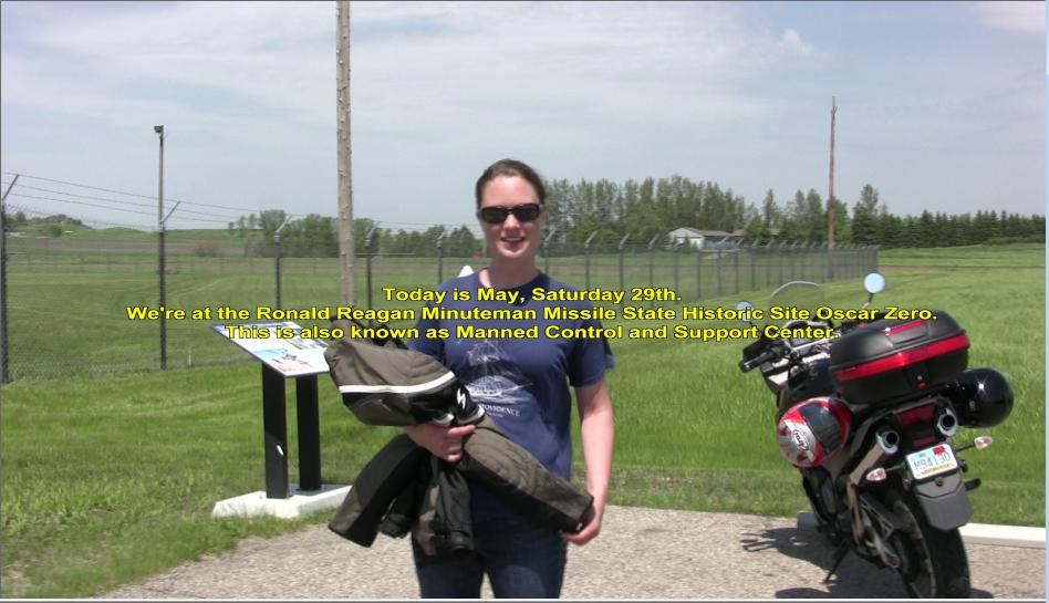

    Let's suppose I have two clips joined with a blank transition inbetween like so:
    Clip1 = DirectShowSource("F:\Clip 1.m2t")
    Clip2 = DirectShowSource("F:\Clip 2.m2t")
    Trans = Blankclip(clip1, length=100).Subtitle("Whatever", size=58, align=5)
    clip1+trans+clip2
    Question 1: How do I use BlankClip with some text to introduce the very first clip?
    Question 2: What is the usage of Subtitle for both clips in the script above at specific frame locations and if subtitles are more than one line long?
    Blankclip(last, length=100).Subtitle("intro text", size=58, align=5)++last
    last ++Blankclip(last, length=100).Subtitle("Whatever001", size=58, align=5)
    last ++DirectShowSource("F:\Clip 2.m2t")
    http://avisynth.org/mediawiki/Subtitle
    Multi-line text using "\n" is added in v2.57 and it is used if the lsp (line spacing) parameter is set. It sets the additional line space between two lines in 0.125 pixel units.

    Check the screenshot. I'd like to display each line with a couple of seconds delay on the bottom to match to when my gf is actually saying them (versus clumped together at the same time). align=2 only displays one line at a time on the bottom. How is that done?
    <img src="http://a03-b03.mypicturetown.com:80/P2PwebCmdController/cache/AO%3D5aqeMx2*NS.jpikl3I%...item.jpg?rot=1" title="" alt="" width="320"height="183">

  29. Why not just make a real subtitle? An SRT or SSA subtitle file? Much easier, in my opinion.

    Because I don't now how to do that. Do you mind telling me how?
