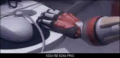

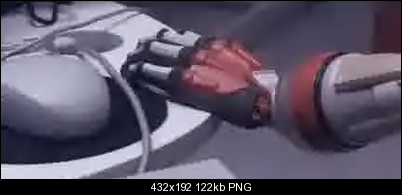

  3. Deblocking filters will reduce the blockiness. But the blocks will become blurs. MSU Smart Deblocking in VirtualDub, before, after:

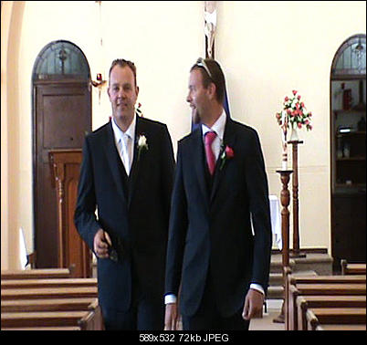

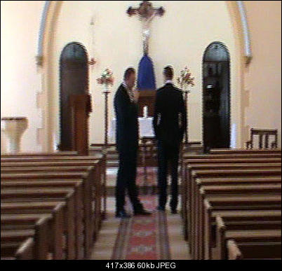

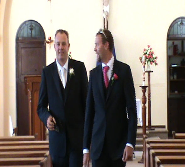

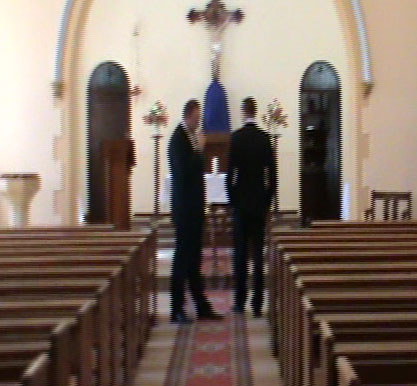

  9. Click image for larger version
ID:	2178 Click image for larger version
    Ok, I can see the interlacing, and having investigated the suggested programs I don't know anything about script writing so that's a no-go.
    Above are some screen shots... the first showing the interlacing and the second showing the lack of detail/resolution in the facial features...

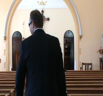

  10. That's not bad. If you are going to DVD you don't want to deinterlace. If you're making a web video you will want to deinterlace. Some deinterlacers give better results than others. Quality ranges from simple discard field and resize (poor) to TempGaussMC_Beta1mod() in AviSynth (very good).
    If you sharpen you have to use techniques that work with interlaced video. As mentioned, LSFMod() will probably do fairly well with that video (it attempts to sharpen edges without sharpening, and hence enhancing, noise).
