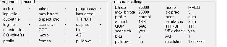

    Are these good settings to use to get a 25mb mpeg2 high def output file? I notice it is outputting an m2v. So that means I'll have to demux the audio each time I do this?

    Edit 5 - SUCCESS!
    I loaded the m2v video file into pinnacle studio 12 plus and it played it back flawlessly! It was at 25mb as EDDV suggested to start at. THANKS EDDV!

    I can even do menus for avchd apparently. It has menus but I don't know if it will work in the avchd world or not. I had a separate thread going on and I"ve been informed multiavchd can do motion menus. Then in that case I can modify my clips in pinnacle and then import into multiavchd for my final project if the menus in pinnacle don't work in the avchd model.
    Edit 7
    Well my first edit worked out great.
    I burnt the avchd folder to dvd and popped it in my ps3. It started right away and played beautifully. One thing I had not anticapated was that the output from pinnacle would be 1920x1080. There must be an output setting somewhere in Pinnacle studio 12 plus to designate the resolution output in avchd mode. Though the video still looked great. Even with conversion to m2v and then back to avchd it looked really good.
    I'm not 100% certain the audio stayed in synch but its darn close if it isn't. I would still like to be able to remux the m2v from hcenc with the ac3 before proceeding. Hopefully that would ensure synch success. I had downloaded imagompegmuxer that was supposed to be able to handle high def m2v video. It did open the file and the ac3 as well but promptly did nothing. It may be the high def audio. Its actually 640kpbs ac3 that I capped from the ps3 with the hauppauge hd pvr.
    Is there something that can mux high def m2v and high def ac3? I'd like to be able to edit the single video file in pinnacle. For some reason since I added the ac3 audio file as background music I couldn't seem to trim the video clip while moving the audio at the same time. I tried locking both tracks and one at a time but no go. I ended up just doing a straight cut. But I'd like to be able to pull both the audio and video together at the same time while trimming. That's where muxing comes in. I want it to be the same file so when I put it in the timeline pinnacle sees it as one entity.
