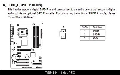

    That MB doesn't have optical S/PDIF inputs, only a output jack. Few MBs do. You would have to convert the optical to electrical (coaxial) and feed it into the MB through the S/PDIF in header. Does the Xbox 360 have coaxial audio out? If not, then you would need a converter like this: http://www.monoprice.com/products/product.asp?c_id=104&cp_id=10423&cs_id=1042302&p_id=...seq=1&format=2 , then a PCI coaxial to motherboard adapter. I made one up with a RCA jack, a blank PCI plate and a spare CD audio cable I had around. But you can probably find one listed on the Gigabyte site.
    And welcome to our forums.
    EDIT: You only need to use Pin 2 and 3. Power is not required. There should be no loss of quality as it's the same signal as the optical, just converted back to electrical.
