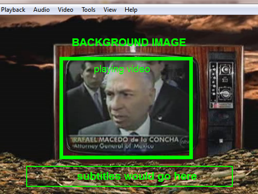

    In the past I have seen videos where somebody actually puts a background, and the small video is part of the larger video, like the image below.
    So on the pic above, the TV is just a background and the video plays, and in this specific video, the idea is that the video is playing on the image of the tv, if that makes sense. I don't care for the tv...I just want the video to be imposed on a larger background so that the subtitles are not limited in size. Or in other words, the smaller video, would be used to create a larger video....

    Simplest would be virtualdub. You can use the resize filter to do two things. First, slightly increase the size of the video. What you have now is literally a postage stamp, and is going to be dwarfed by the subtitles. If you can increase the size, even by 15 - 20 %, then you are better off. Next, you can add borders (in the same filter, at the same time) to increase the overall resolution of the video. In virtualdub these will be a single colour, not actual video, but frankly I believe that is better and less distracting than having some unrelated film running by in the background.

    VideoStudio Pro x3-it's a piece of cake-just overlay and resize, locate on the overlay track. Place background on main track. You can add subtitles
