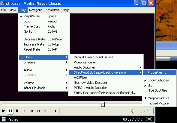

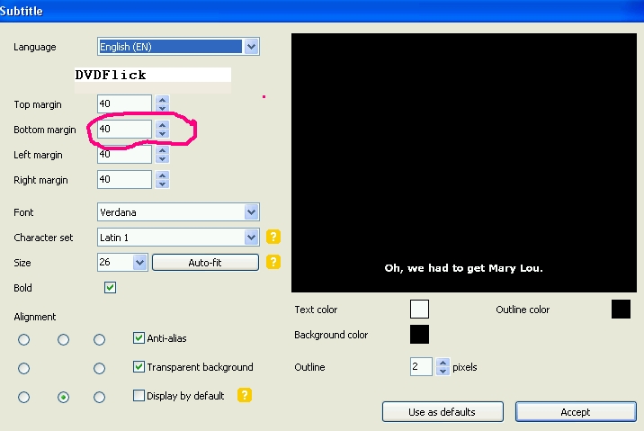

  8. If you have avi with srt subtitles, you can use something like Media Player Classic with Vobsub and position the subtitles any way you like. (see screenshot 3 and 1). Or if you want to convert the avi/srt to DVD, you can use something like DVDFlick and set the subtitle position any way you like. (see screenshot 2) Then the DVD will play back on standalone into your TV with the subtitles position set to your desire.

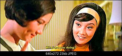

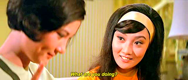

  9. I don't re-encode the videos myself. And I don't think that DivxLand Media Subtitler re-encodes either. And I'm not going to make a dvd either. I am going to post some videos on my Facebook page. I'm posting these two sample pictures just to give you the idea about what I want to do.
    In the file above, you see that the subtitles are still in the lower area of the frame.(That snapshot is not from my original clip. My clips are encoded into avi files with aspect ratio of 4:3 and have black bars above and below).

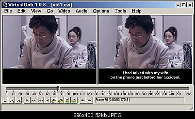

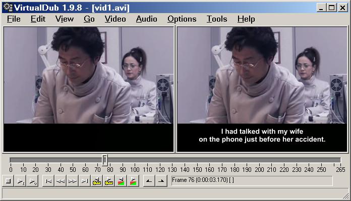

  10. I know what you want to do. My point is that programs that render SRT subtitles normally just put them near the bottom of the frame. They don't know the difference between real picture and black bars encoded into the frame. If the video has a black bar at the bottom of the frame and it is thick enough the subtitles will be in the black bar. If your black bar isn't thick enough you have to make it thicker (and recompress) or find a setting in the software that will let you lower the subtitles.
    Here's a little sample video with a thick black bar at the bottom of the frame and an SRT file for it. Most subtitle renderers will place the subs completely within the black bar. Not because they know it's a black bar but simply because the black bar is thick enough.
