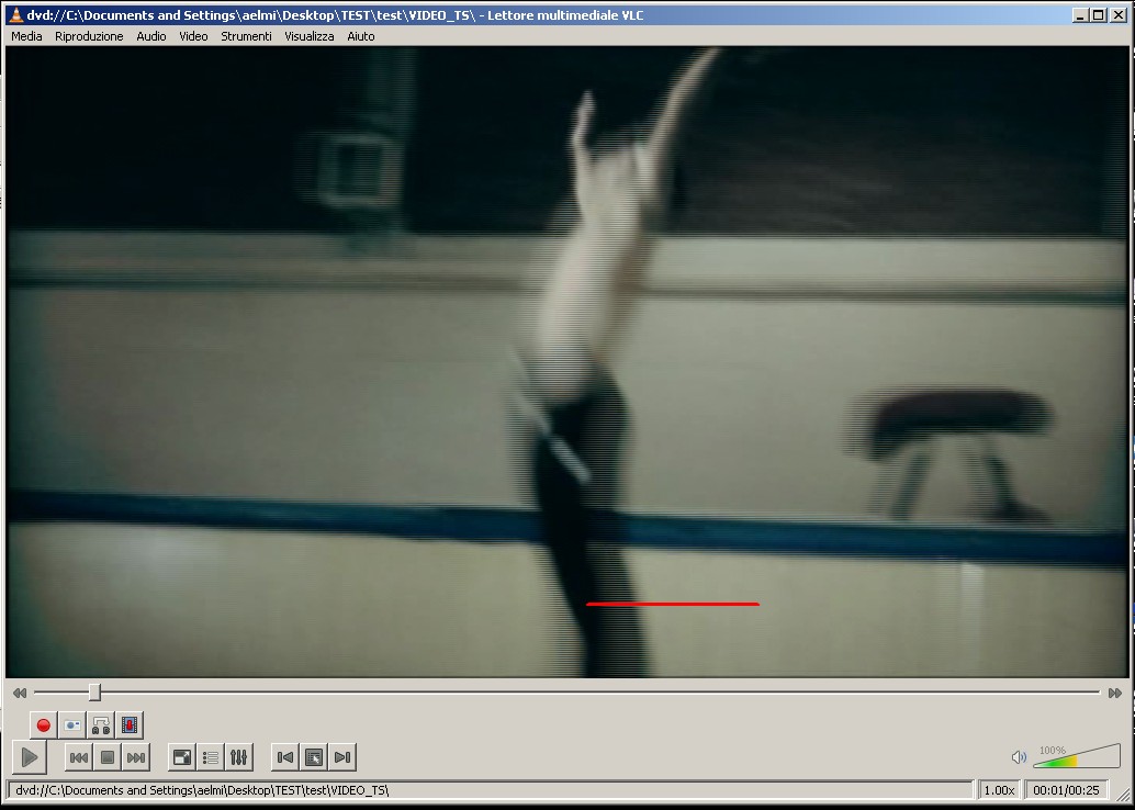

    I'm using DVDAuthorGUI to author a home-made dvd. Is there a way to set a delay before buttons appear? What I have is a m2v as a titleset menu, there's a short animation (2-3 seconds) and then buttons appear... I mean... they appear as labels in the video (they are part of the video). The real buttons (which are used to navigate inside titles) start showing from first frame of the video, and you see a red line (my buttons are lines) while the background is different and labels are still somewhere else...

    I try to attach a couple of pics. They are two different frame from the animated menu. The three labels appear after some second but the button is already there (the red line)...
    Any suggestion?

  3. Found! Solved!
    Thank you anyway... in advanced options I have spu begin and spu end, which allow the user to custimize when the subpictures (buttons) actually begin showing.
