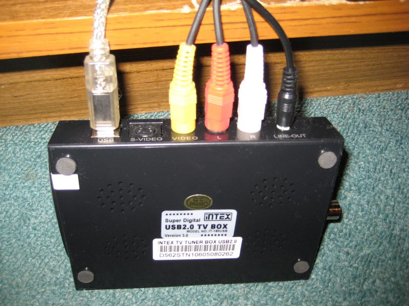

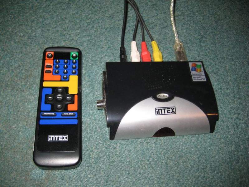

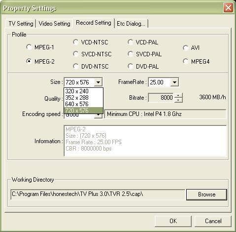

    Here are pictures of my capture card:
    My capture device is one of those generic Chinese devices, picture below.

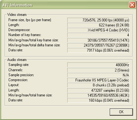

    The ORG picture is of the file information taken of the original untouched uncompressed video file right after virtualdub finished the capturing.
    The Xvid picture is the end result with the following is what I've done:

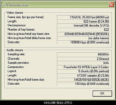

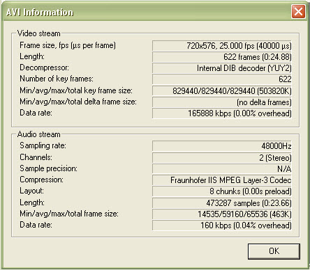

  11. Morning Dave,
    No I'm setting up virtualdub to capture with NO compression in both audio and video, and this is what I get:
    I don't know why it's showing audio as MPEG 3, I'm choosing PCM !!! Another thing, during live capture, It's not dropping any frames, but it's INSERTING about 100 frames for every half and hour of video, is this normal?
    I'm all set now, I will do all the filters you mentioned and do a test run, then copy all the test files on to a DVD and try them out on all my DVD players and get back to you.
    God Bless.

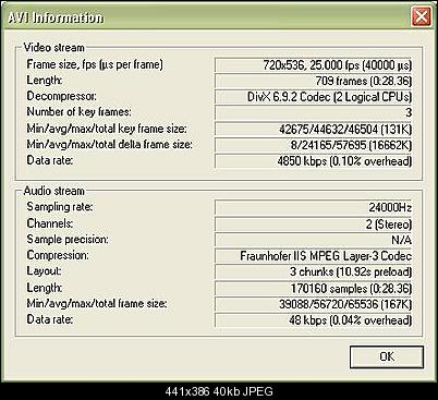

  12. Ok for the final:
    CAPTURING:
    RAW audio and video at 25fps 720x576 YUY2
    Encoding:
    Divx Home Profile, Encoding Presets at 8, 1 pass quality based. Target quantizer: 2
    Filters in this order:
    - Built in deinterlacer, default settings.
    - Chroma filter, default settings.
    - Built in resizer with all the default settings except choose "Aspect ratio compute to 4:3" codec friendly sizing (multiples of eight)
    Audio > MPEG Layer 3 48 kBit/s 24,000 6KB/s
    Here is a screenshot of the file info and a 30 second clip of the final product, I played it on the DVD players in the living room and it looked alright to my untrained eyes, of course it's nowhere near the quality of the original when played back direct to the TV, but I guess this is how it's supposed to be.
    Take a quick look at it and give me the all clear sign if you think all is OK. Note that during capture virtualdub is INSERTING about 100 frames for every half and hour of video, is this normal?

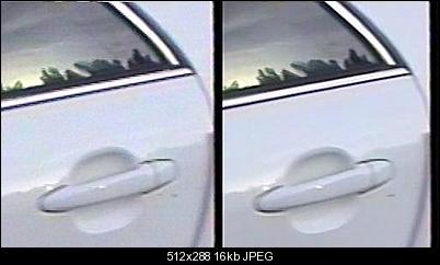

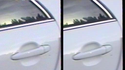

  13. Originally Posted by FatBoy123 View Post
    If it helps here is a very short 3 seconds clip taken from the original captured video directly from the capture card, untouched...
    http://depositfiles.com/files/z513i41m3

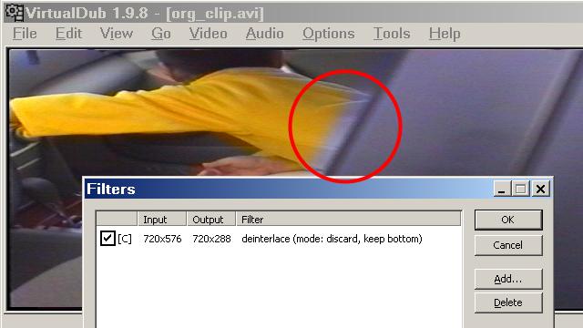

    There's something wrong with the chroma channels in that video. The bottom field appears to be using the chroma channels from the top field:
    You should look into fixing your capture method. The top field is ok.
    If you want really good deinterlacing look into AviSynth's TempGaussMC_beta1mod(). It will get rid of most of those buzzing near horizontal edges. It's really slow though. Yadif on the left, TGMC on the right:

    Finally I reviewed your family scene AVI, it looks good. Bitrate is 4850 Kbps; no hard and fast rule about that,
    as long as your standalone will play it - some machines may find it a little high and choke.

    FatBoy123, On the subject of archiving, if you're going to deinterlace with VirtualDub's Yadif mode, I recommend you use the double frame rate option (top field first for your video). The files will be bigger, and some players may have problems keeping up, but motions will be smoother. Compare the 30 fps and 60 fps examples in this post:

  18. I will look into those last two points you mentioned and do a test run, Note that I mentioned virtualdub is INSERTING frames not dropping frames if that makes any difference, Anyhow I think we have now covered all the important basis and I'm just roaring to go.
    I would like to wholeheartedly thank Dave and jagabo for your kindness and determination in sticking with me.

  19. Try changing VirtualDub's A/V sync feature. One of the settings may alleviate your drop/insert frame problems. Capture -> Timing... Of course, check the A/V sync after capturing.
