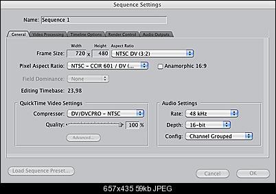

    Im using this settings on the clip:
    does that look correct? Im thinking mainly on the NTSC DV 3:2. does that mean that Ive got the pull down flag and that it will play correct in a NTSC DVD?

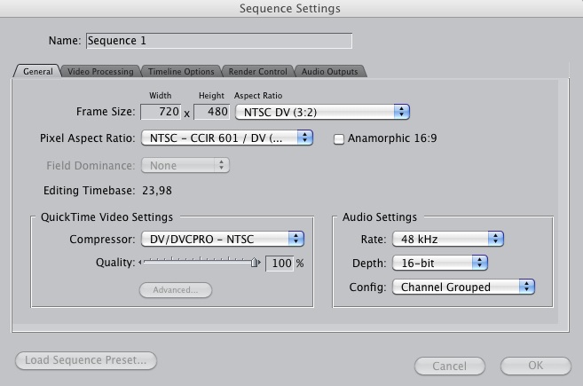

    whoops, sorry. this shall be the correct footage:
    been experimenting a bit so accidently took the wrong one.
    Is this correct then?
    how can I see if I got the 3:2 flag?
    do I already have the 3:2 flag in the picture above?
    and what does it do?
    thanks
    Perik
  4. I don't use Final Cut so I can't really answer your question. But the 3:2 in the pic above refers to the resolution aspect ratio. 720/480=1.5:1=3:2.
  5. Originally Posted by manono View Post
    LOL. I didn't notice that. I suspect the OP's setting's wont work because he is set to use a DV encoder. The program will probably duplicate every 4th frame (to create 29.97 fps from 23.976 fps), resulting in jerky video, or simply encode the 23.976 fps video at 29.97 fps, resulting in faster playback.
    Jul 2009
    Spain
    Note also that the source movie is actually 25fps, not 23.976, so 3:2 pulldown is not applicable anyway.
  7. He said his video "is now in 23,98" but I don't know what he means by that. Did he slow it down? Did he throw discard 1 out of every 25 frames?
    Nov 2008
    final cut did that. just to get it down to ntsc. dont know how to do this otherwise. any tip? using compressor makes it look terrible.
    DVD studio pro?
