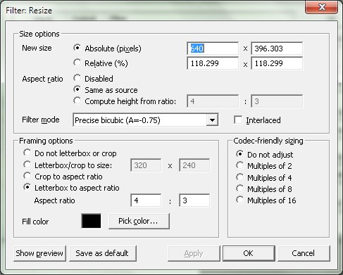

    Add the resize filter and just select letterbox to aspect ratio 4:3. Then add the subtitle filter and you should be able to get the subs in the black area.

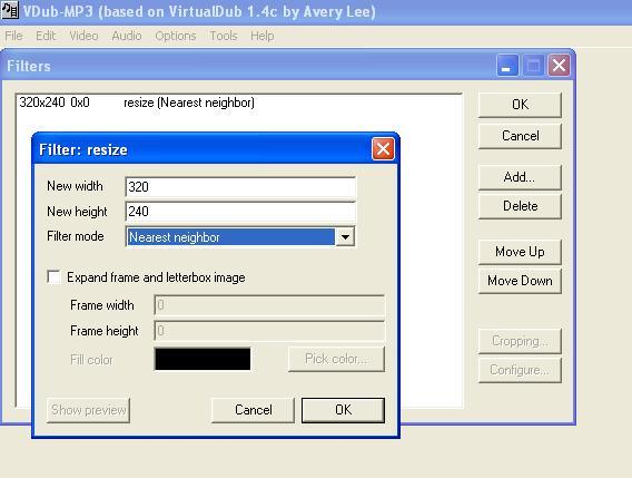

  3. Thanks for the reply dear Baldrick
    but the resize filter gives the image that I attached , not your screenshot !
    so, please tell me how can I get that plug-in ?

    Use a newer version of virtualdub.....
    But you can also use that VERY VERY VERY VERY old version, select expand frame and letterbox image and set it to 640x480(or any 4:3 size). Set the new width to same width but with a 16:9 height like 640x360(if your video source is 16:9 then).
  5. Thanks alot Baldrick , my problem solved ...
