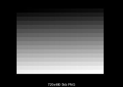

  13. RGB source (all 256 shades of gray):
    After HuffYUV 2.1.1 in RGB mode:
    After HuffYUV in RGB-->YUY2 mode:
    Using a tool like CSamp shows there are no pixels where R=G=B isn't true. If you are getting discolorations it is happening elsewhere in your processing. Or whatever version of HuffYUV you have is broken.

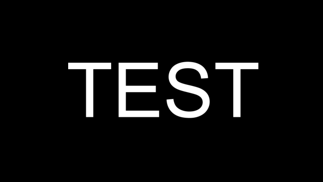

  14. With me, after using huffyuv and x264, ffffff becomes fdfdfd. The same thing happens when I don't use a codec (uncompressed). After using QT's MPEG-4 and x264, nothing changes.
    might be from the colorspace conversion. QT's MPEG-4 is already in YV12, as is x264. Exporting Huffyuv (YUY2 or RGB/A) then converting using x264 requires colorspace conversion

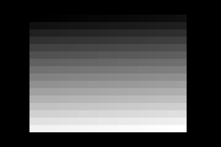

  25. Originally Posted by roflwaffle View Post
    I'm using windows media player and the decoder is ffdshow. I don't think it's an issue with my PC, because I took a screenshot and checked the colour. Also, I did a test upload on youtube.
    Samples (huffyuv vs huffyuv+x264): http://www.mediafire.com/?dwz02yzlnz3
    You can't take a screenshot from wmp, the levels will be washed out (it takes in VMR9(renderless) mode)
    Youtube adds another level of complexity, but your uploaded samples are nearly identical (except one is RGB32, one is YV12) when decoded properly. These screenshots were taken in AvsP (independent of renderer) , the YV12 video is converted to RGB with Rec.601 Matrix for purposes of the .png screenshot
    I think this is a configuration or playback issue on your end
Name:	huffyuv rgb32.png
  26. Originally Posted by roflwaffle View Post
    That's not a discoloration (fdfdfd is still a gray shade), it's a levels issue. RGB uses 256 levels of gray, YUV normally uses 220. So 256 levels have to become 220 when converted to YUV. So with 8 bit YUV samples there is no way for every one of the 256 gray levels in RGB to be retained after a RGB to YUV to RGB conversion (you can see this in my YUY2 sample image). Different programs use slightly different methods to perform the conversions and will give slightly different levels.
    https://forum.videohelp.com/threads/296961-TV-Safe-Colors?p=1812482&viewfull=1#post1812482
    You can use AviSynth to convert to YUV with 256 gray levels:
    ConvertToYUY2(matrix="PC.601")
    and then you have to use the same matrix to convert back to RGB with:
    ConvertToRGB(matrix="PC.601")
    Your TEST.AVI file is encoded by HuffYUV in RGB mode with black=0, white=255. Your TEST.MKV is encoded as YV12 h.264. Black is at Y=16, white at Y=235. This is normally converted to RGB black=0 and white = 255 for display. Your problems are not caused by HuffYUV. They are elsewhere in your processing.
