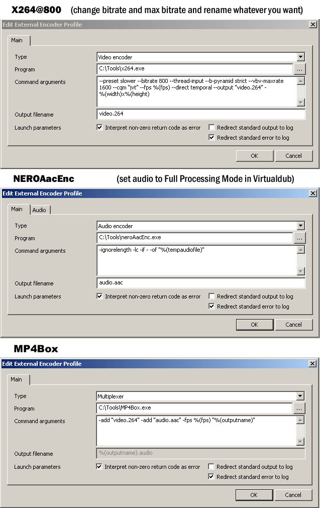

  28. Member
    Nov 2002
    Using External Encoder in Virtualdub 1.9.X test20
    http://forums.virtualdub.org/index.php?act=ST&f=5&t=18789&
    http://www.virtualdub.org/beta/VirtualDub-1.9.X-test20.zip
    Directshow Input Driver (can open MKV in Virtualdub with this and latest Haali media splitter)
    http://www.virtualdub.org/beta/DShowInputDriver-mediadettest.zip
    I used...
    x264.exe for 264 encoder
    NeroAacEnc.exe instead of ffmpeg (could not get ffmpeg to work) for aac encoder
    MP4Box.exe to mux into MP4 container
    x264 800
    --preset slower --bitrate 800 --thread-input --b-pyramid strict --vbv-maxrate 1600 --cqm \"jvt\" --fps %(fps) --direct temporal --output \"video.264\" - %(width)x%(height)
    neroAacEnc
    -ignorelength -lc -if - -of \"%(tempaudiofile)\"
    MP4Box
    -add \"video.264\" -add \"audio.aac\" -fps %(fps) \"%(outputname)\"
