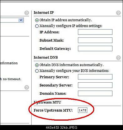

    I don't know if it's relevant or if what I tried was the final solution, but I couldn't get on Yahoo sites.
    I could ping them OK, but no connection.
    I finally changed the router MTU setting from 1492 to 1472 and rebooted the router.
    It has been working for the last 3 days ok.
