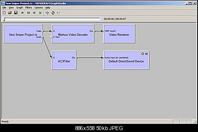

  18. what directshow splitter and decoder are you using for MPC?
    I have no idea
    I've opened graphstudio but if i try to drop in dgsplit.ts it cannot open the file.
    If i drop in New Sniper Project.ts, it shows this
    Does that answer your question(s)?
  19. yes it does, the 2nd box "ffdshow video decoder" is your directshow decoder
    I suspect if you updated your haali media splitter to the newest version , that you could open the 2nd sample. It decodes with a different size (there are black borders), because dgsplit cuts raw files (the files are actually encoded to mod 16, so 1440x1088 , not 1440x1080)
