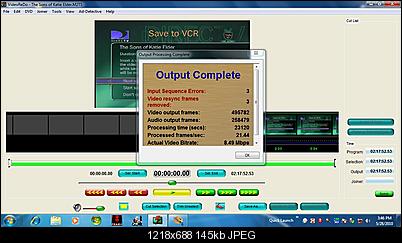

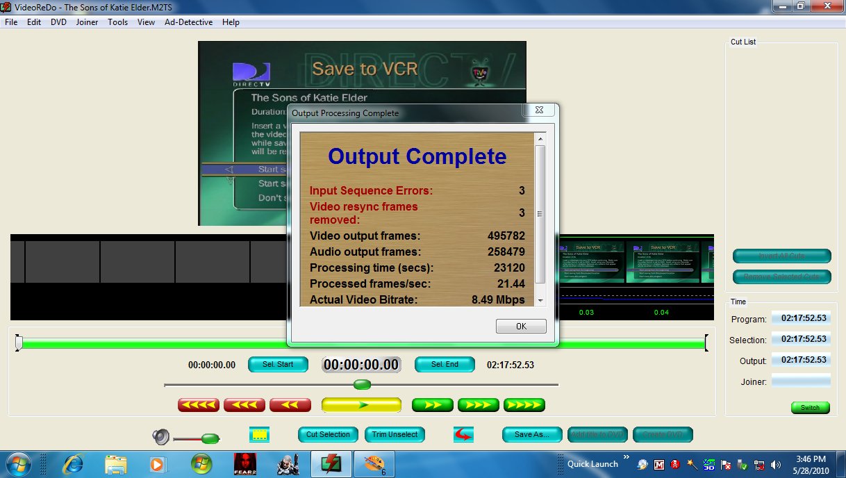

    Last night I downloaded version 4 of Video Redo ... VRDTVSH264-4-20-5-600.exe. Crap happened ... I did have version 3.20 installed and it interfered with using the trial key for 15 days of full functions. Being able to use it for 15 minutes of video is not enuff to see how well it works.
    So I rebooted to WIN 7 and installed it ... and I now have full functions for 15 days. Works just fine in WIN 7 Ultimate x64.
    I loaded ... Sons of Katie Elder.m2ts ... and since it was late ... I told it to save as a mpg video and went to bed. Here is what it said when I got up ... hours later.
    Here is the screenshot of what it said ...
Name:	VideoRedo Errors in Sons of Elder.jpg
    VRDo 4 ... found 3 errors and it played just fine ... now to trim the excess junk off and see if ... ConvertXtoDVD 4 ... can process it correctly.
    I will post the results from doing this.
    Question ... This trial version of VideoReDo 4 Suite ... seems to work well ... If I give in and pay 95 bucks for the full version ... will this be a forever subscription or will I have to pay again ... a year later when they update the program
