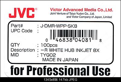

    been all i have been receiving for a couple months from meritline.

    Hoo boy, I have been having issues with the new-branded JVC TY disks whose label is shown in the previous post.
    A bit of background first -- I video my wife's group performances at the end of each quarter and provide the movies on DVDs to the participants. Most play them on set-top players, the rest on their computers. I had learned from painful experience that the Taiyo-Yuden 8x DVD-R "premium packs" from Supermediastore.com played on almost everything -- old set-tops, new set-tops, and any computer dating back to early Macintoshes (but not on HP, though). The 16x did NOT play well on set-top players, even though it did work on almost all computer DVD players and/or recorders.
    About the time the label changed from Taiyo Yuden to "JVC for Professional" use (yeah, right) things went very awry. These disks will burn and verify perfectly on the computer, and in fact will verify perfectly on my Pioneer 111D ver 1.23, 116D ver 1.09, and a NEC ND-3550A -- burn on any and verify on any -- all perfect. HOWEVER, they play without error on VERY FEW set-top players. Not acceptable for my needs.
    I can't say they're defective because they work fine on computer DVD drives. But I can't use them because they will not play on people's set-top players.
    Anyone have an answer to my problem?
