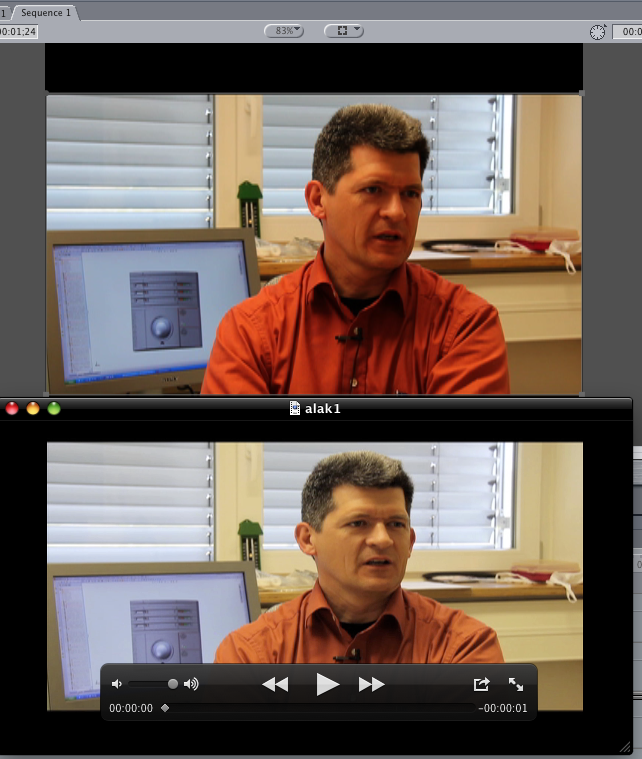

    oops! spoke too soon - it still doesn't look right. See attached image. The one at the top is in FCE, the one at the bottom is in quicktime.

    Settings?
    I can't replicate this here. My FCP box is being rebuilt.
    It is a settings issue for project or Compressor. Or the source file is not flagged 16:9.

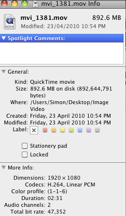

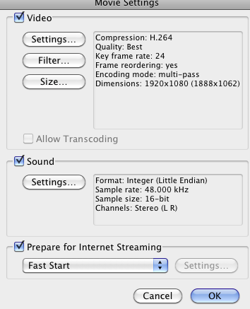

    The footage is capture in 1920x1080, and I'm trying to export in 1920x1080. Its weird, with the previous two cameras I had there were no problems like this.

    Ok, this is weird. I found that that I export in QT using 4:3 ratio it looks correct! How is this possible when the source video is 1920x1080?

    Somewhere in the source properties, project or movie settings.

    First FCP is very fussy about import formats. The source must be properly flagged as 16:9 preferably in the AVCHD or Quicktime h.264 format (latest version only). The project setting must be 16:9 1920x1080. Frame rate must be set to 24p progressive.
    First clue is whether the preview pane shows what you want.
    Then focus on encoder settings.
    Four black borders normally result from 4:3 (assumed) video import to a 16:9 project. This results in pillarbox preview. If you haven't identified the source as 16:9, most edit software will assume 4:3.
    Then encoding this to 16:9 causes the pillarbox to be letterboxed. Result is four black borders.

    worked out what I did....I didn't set the sequence settings to 1920x1080 before bringing in the video from my HDD!!! Thanks again for your help edDV!
