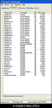

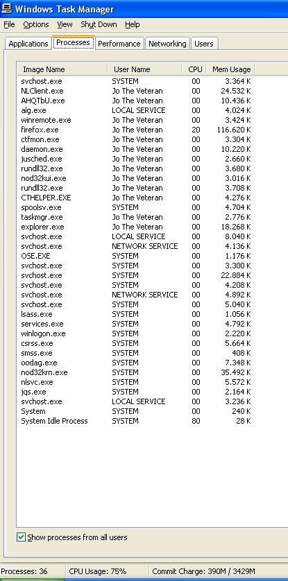

  1. This problem started 2 or 3 days ago and now that I'm writing this it's also happening for the 4rth time in total. I can describe it as a system lag that could have been caused by a heavy CPU demanding program, like video encoding when run in normal priority. When it happens, i cannot soft reset or shutdown and if i hard reset the PC, it goes away for a while, but it can start again at any given time, more commonly when the PC is on for many hours.
    The process is not shown in the task manager
    [Attachment 1984 - Click to enlarge]
    <----(I don't know what this "attachment" thing is, or how to remove it, pardon me)

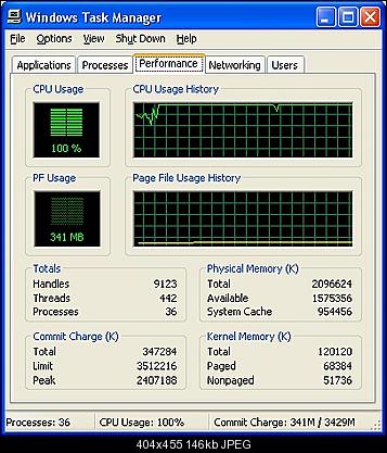

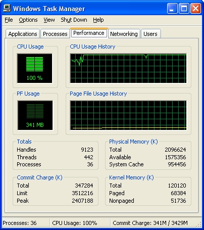

    still CPU is being used at about 80% constantly, 100% now that I'm using Firefox, and that shows at the performance tag
Name:	CPU Drain.jpg

    your numbers in the task manager add up to 100% 20% ff and 80% idle. the weird thing is system idle shouldn't show up in cpu usage/history in the performance tab. somethings not quite right. i'd use gmer and check for rootkits that a/v can't find.

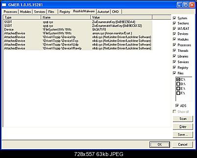

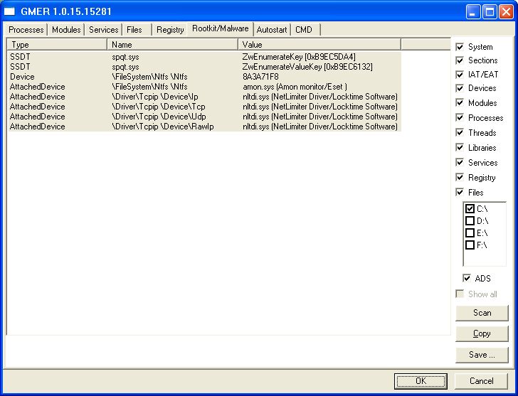

  5. Downloaded Gmer rrotkit/malware search on C:/ produced these results.

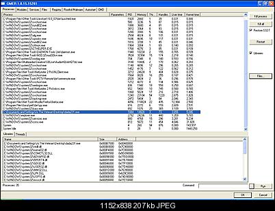

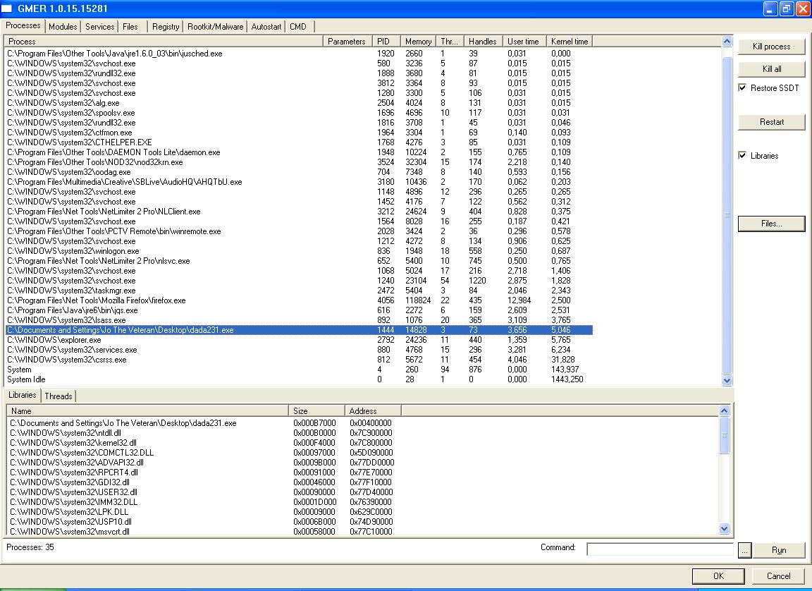

    and these are the processes described by GMER, if you can make heads or tails out of it.
    They are categorized by kernel time and the last on top of the screen that can't be seen is the smss.exe file in system32,
    also the one underlined is the GMER.exe that is changed into a random .exe so mallware programs will let it run.
Name:	GMER Processes.jpg

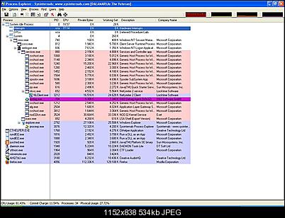

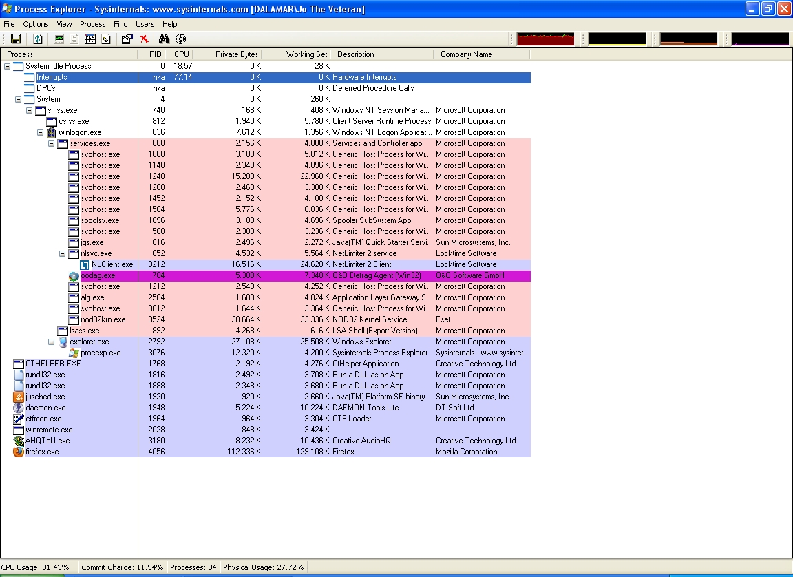

  6. Holy shhhh... am in trouble now, aren't I.
    This is what process explorer shows
Name:	Process Explorer.jpg

  7. ok i have rebooted and now show 0% hardware interrupts and the system runs fine.
    From what i read in other posts interrupts up to 80% of CPU usage could be caused by an IRQ resource error (and DMA to PIO error but that checked ok), when two major devices, like graphics card and sound card use the same number and from what i saw this exact thing happens in my system (IRQ 16).
    I just don't get why this happens now of all times? Why didn't it happen one month or a year ago?
    In any case I'll move the sound card into another PCI slot tomorrow, so that it could be assigned another IRQ number and see from there.

    the gmer rootkit scan looks fine, but the next time it's acting up load gmer then click on the processes tab to see if there are any hidden processes running. they will show up in red.
    hopefully it's just a hardware issue though...

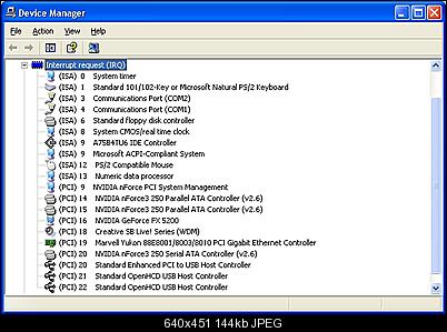

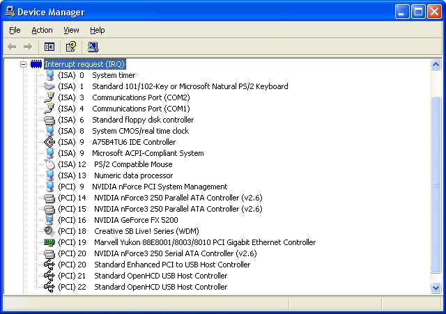

  18. I don't remember doing anything of the sort, however it could have been turned on but default by the motherboard constructor.
    This is how the IRQs are distributed now that i moved the sound card.
    It used to be after the Nvidia card again but with the same IRQ.
    Notice that i STILL have devices sharing IRQs, just not so important or resource demanding i guess.

    I don't think it's much of a problem sharing IRQs between some devices. Your IRQ 9 seems to be used by similar devices. But usually the video card needs it's own IRQ as it can use a lot of resources. I remember when I used a 939 MB that I did have to juggle PCI slot devices around when I set it up. With newer MBs, so much is incorporated into the MB, such as sound chips and LAN chips, that IRQ conflicts are less common. And I think newer MBs have better methods of assigning IRQs to avoid conflict.
    But if your problem is resolved, that's great.
