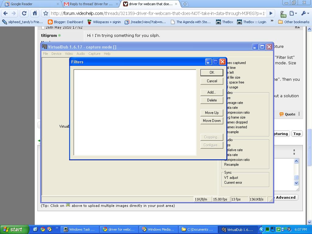

    If it works, then you can add a filter in "Video" Menu and "Filter Chain" ticked enabled. And in the "Filter list" "Add" and choose "flip horizontally".
    I don't have a Video > 'Filter Chain' option, but i do have a Video > 'Filters...' option.
    if i go into it, i get what you see in the uploaded attachment.
    This works when you choose in Video "Format" and "RGB24" mode.
    when i go into Video > Format, the only option i have is MJPG! i have no other option to choose from in the dropdown list!!
    what do you make of this...?

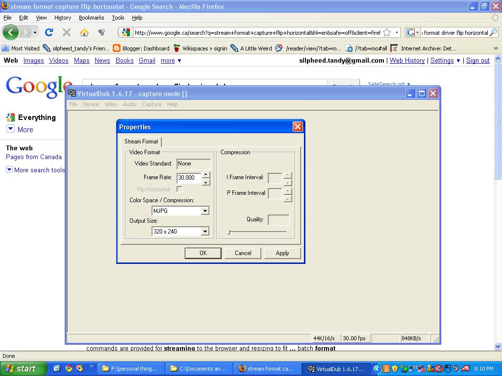

    i've got to admit, i wish i knew why it was grayed out! if it wasn't, i'd be satisfied enough!
    the attached screenshot is what i get when in Virtual Dub, then going into "File > Capture AVI..." mode; and then choosing "Video > Capture Pin...".
    (note, "Video > Capture Filter..." has no horizontal flip option)
    [to be clear, i rolled back to a system restore point made just before installing the newest driver (ie from the second webcam i bought) as i mentioend in the earlier post. that is, the attached picture is from the webcam driver that windows XP SP3 suggested and installed for me]
    it's driving me a little bonkers, like it's mocking me or something, lol. i mean, the option is /provided/, but it's just that it's *grayed out*. can anyone explain why it is grayed out?

  11. Regarding the grayed out horizontal flip option: when you capture using YUY2 or RGB the driver and capture program are receiving uncompressed video frames. It is easy to flip those images horizontally. But when capturing in MJPEG mode the video frames are compressed. It's much more difficult to modify compressed video. It has to be decompressed first. That's probably why the option is disabled when capturing MJPEG.
    You should be able to get VirtualDub to capture YUY2 (or other YUV mode) or RGB and compress with a fast compression codec like HuffYUV and still maintain a 30 fps frame rate.
