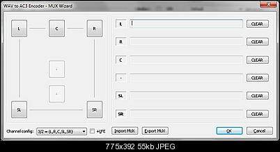

    The old Sonic Foundry Soft Encode or ?
    Maybe try convert with the free EncWAVtoAC3 ?

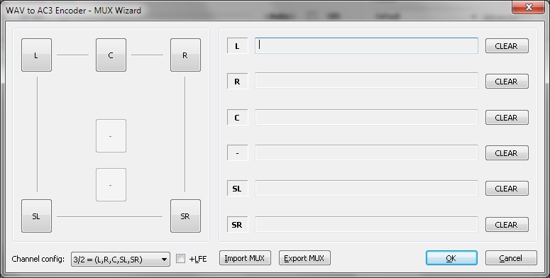

    Crap. I'm getting the same results
    Not to mention that I need to read whatever documentation is included, as the channels aren't playing in the proper order. The order is supposed to be FL, C, FR, SL, SR, LFE.
    I attached the AC-3, in case you need it as a reference

    In the case that you haven't given up on me, attached is a zip containing 3 tests. Don't worry, they're even shorter than before. They work fine up until the surrounds. I encoded them to play in the following order: FL, C, FR, SL, SR, LFE. When it gets to the surrounds, the SL plays in the front-left and the SR plays in the front-right. It's the same for me with all 3 tests.
    The first two tests are "Soft Encode"d. The first test is at 48khz and the second at 44khz. The last test is the "WAV to AC3 Encoder". With that one I have no clue what pretty much any of the settings are, as I just left them at "Auto".
