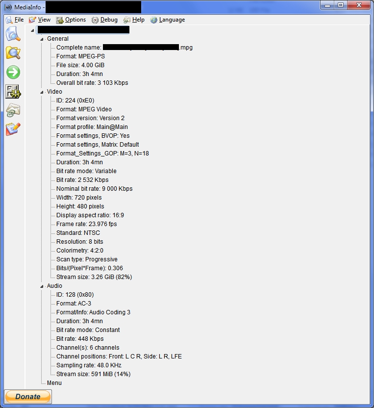

    Can you post a mediainfo tree view output of the mpeg-2 file in question ?

    Here you go. GUI For DVDAuthor properly created a VIDEO_TS folder for it, but I was unable to create a nice chapter page. If that's the best I can get, I'll settle for it, but I don't see why the others won't work. I'm going through DVDStyler's instructions, but it's not very intuitive.
    I should add that even DVDFlick wants to re-encode the file.

  10. Your framerate is 23.976fps so I take it you never applied pulldpwn so it'll show as 29.97fps in MediaInfo. Therefore it's non-compliant, therefore no authoring program will author it without reencoding it, that's if it even accepts it to begin with. Apply 3:2 pulldown using DGPulldown (demux first) and then try again.

    Assuming the MPEG is solid, demux it with DGIndex, then use DGpulldown on the video stream to add 3:2 pulldown to make it compliant, then author with whatever you want. If it still doesn't author then it is back to the source because your encoding is flawed.

    TMPGEnc accepts it fine, until I go to create the disc and I get the following error - clip GOP too long for a DVD-Video The track's GOP length is too long for a DVD-Video. The GOP length for a DVD-Video must be equal to or less than 18 frames. If you are authoring a DVD-Video in XDVD format you can ignore this warning.

    Your N/M settings (which determine GOP size) in that pic are screwed up. For NTSC 23.976fps encoding with pulldown, M=3 and N=12 are the best settings. Try again.
