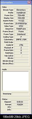

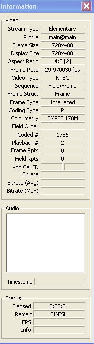

    Hi there! I'm having some problem which i supposed hapeend during/after deinterlacing when i ripping some stuff fro me from DVD. I'm using meGUI for making script and vdub for encoding. When i "analyze source" in meGUI it says:
    Source: Hybrid Film/Interlaced. Mostly interlaced
    Field Order: Varying Field order
    Here is DGindex info for source:

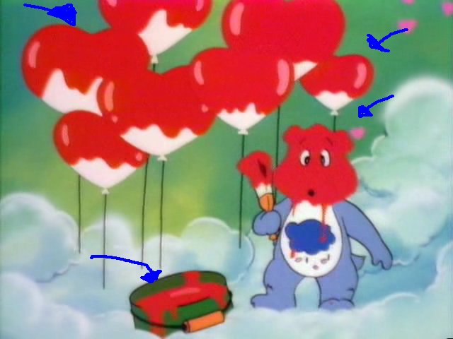

    Here is how it looks like after deinterlacing,in this case TIVTC (tfm(order=-1).tdecimate(hybrid=3)
    Screenshot can not introduce my problem very well,but problem is under ballons (almost every red colored area). You will see that in video!

  2. looks like xvid compression artifacts
    either use a higher bitrate (lower quantizer) , or better compression (e.g. h.264)

  4. exactly what are your arrows pointing to?
    the bottom arrow is definitely a compression artifact

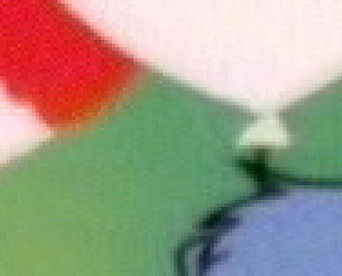

    nope, as mentioned above, it's dot crawl
    bob deinterlacing won't fix it, look closely in vlc bob for example, it's still very bad. You can use an avisynth filter like checkmate or tcomb
    you have a messy source, it requires a bit of work to improve it, I'll post something a bit later

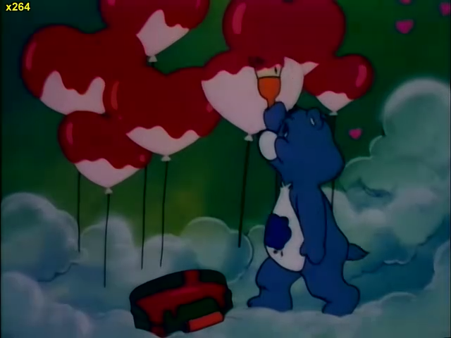

  15. 1) The first screenshot is the original, just TFM().TDecimate() to IVTC
    2) The 2nd is treated with the script, not cropped or resized
    3) The 3rd is same as (2) , but cropped and resized
    These were taken before compression.

    original IVTCed
    script
    script with crop & resize

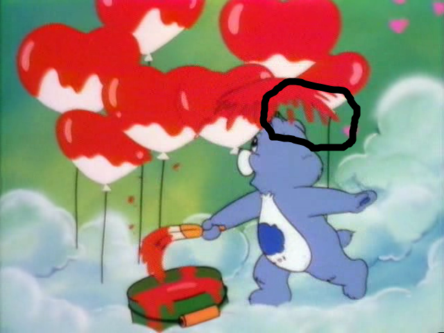

    dot crawl is another topic, that looks like "buzzing" dots when played. On a framegrab, I circled it above - it sort of looks like a "waffle" pattern

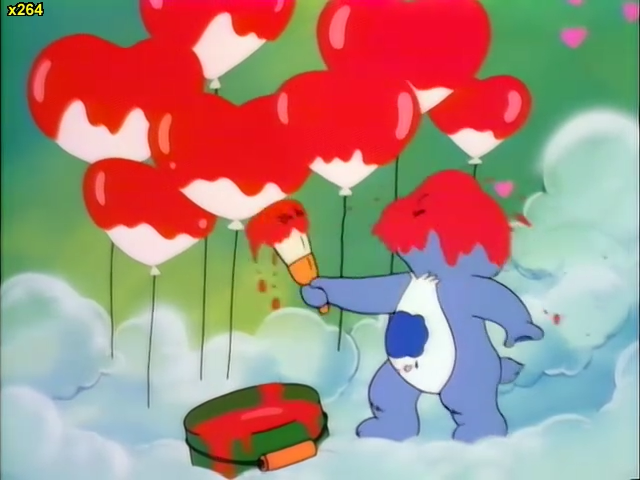

    Here is an example using the same script using x264 at ~500kb/s , the video is attached below
    Below are representative screenshots, notice the artifacts along the lines in the xvid encode. The fact is, every frame is better with the x264 encode, even though it is using ~1/2 the bitrate. If you example the beginning sequence fade in, the xvid encode is very bad, with blocky looking artifacts.
    Here is a script to compare the 2, you could open the .avs in avsp or vdub, for example, and just
    push the arrow key.
    a=AVISource("xvid 1Mbps.avi").subtitle("xvid")
    b=FFMpegSource2("x264.500kbps.mp4").subtitle("x264")
    Interleave(a,b)
