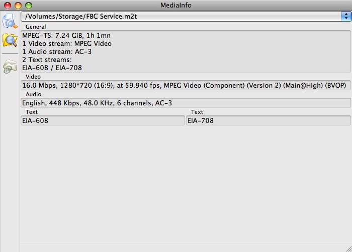

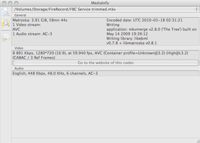

    Very interesting! I wish the grid had the AVCHD disk spec as well. Here are screenshots of the details on the original ts file and the mkv I transcoded to. My intended use is to make a disk that will play in my friend's Sony BD player, and hopefully my LG BD390 as well.

  6. transport streams have much more overhead (like 7-8%) ,so you will often overshoot if you don't calculate bitrate correctly
    there is a mac version of avchd calculator to find the bitrate
    http://tools.twanwintjes.nl/index.php?page=avchdcalc
    it looks like you are using 720p60 . Since you are using <15Mb/s you don't need 4 slices, and can use Level 4.0. You would have to translate these values into the handbrake gui - I don't use handbrake).
    there are many optional settings you can use (like changing motion estimation , deblocking strength etc...), but the key things you NEED to add or change in addition to the bitrate

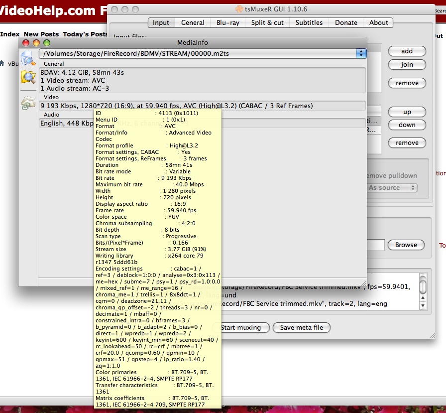

    Btw, here is the Info on my actual AVCHD stream (m2ts) created by TSmuxer.

  11. For example, your last screenshot shows a way too large gop size 60-600 , and no vbv buffer values. Hardware players require this buffer to prevent stuttering and smooth playback. Large out of spec GOP sizes can cause stuttering, black screen, or issues with FFD/RWD
    As mentioned earlier, one problem with tsmuxer is that it overwrites HRD values, so even if you have a compliant stream , it can MAKE them not compliant. Some streams may work, some may not, it will vary because if the values it writes "fit" with that particular stream - you might get lucky. Note, the majority of hardware players can play out of spec streams, but it might be something you don't want to risk. For example, the PS3 could probably play your stream there
