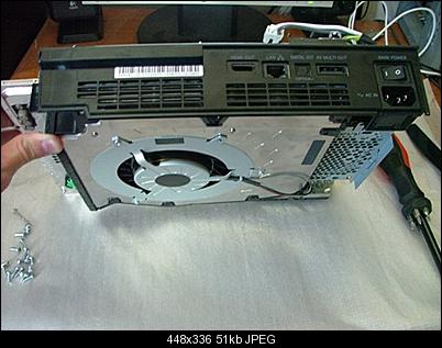

    Just about any power brick that puts out 12VDC @ about .5A (500MA) or more would work. From that PS3 site, it appears the PS3 has a large fan, apparently on the bottom of the unit. I'd probably check more for dust before I would consider taking it apart.
