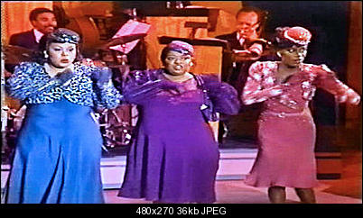

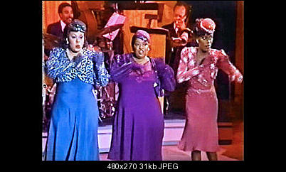

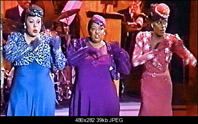

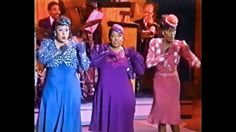

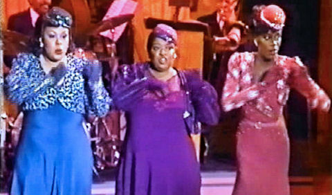

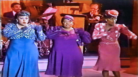

    Pictures tell it all, several jpg's of a single 4:3 frame
Name:	cropped and resized.jpg
ID:	1940Click image for larger version
Name:	correct size and AR.jpg
ID:	1939Click image for larger version
    cropped original stretched

    both of you have great justice to what you say, although it is a fashion to make certain movies crop
    this film is remastered, so the more so not worth..
