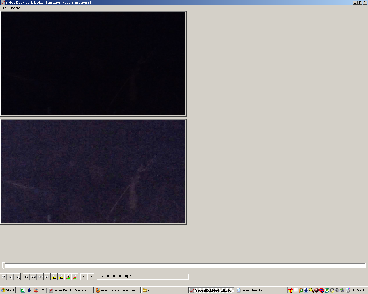

  11. Top screen is what you see if you play back the original file.
    Bottom Screen is with the VDUB Filters using your AviSynth Script and MSU Filter.

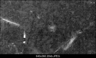

  12. Pretty tough video. You might be able to squeeze a little more out of it with Neat Video noise filtering.

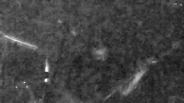

  13. Thanks. Checking it out now. How did you get the frame brighter? Any particular presets to try? The picture you posted is pretty much what I am looking for.
  14. I thought Neat Video would work better with an image that wasn't too harsh so I used two Levels filters, one before Neat Video and another after. The settings for the first were 0, 2.5, 32, 0, 255, the second 90, 1, 210, 0, 255. When in the Levels filter dialog you can use the Preview option to see a preview of the results, and the Sample Frame option to see a histogram (as a guide for setting the sliders). You should try variations of this to see if you can get better results.
    You can also try disabling the "operate in luma instead of RGB" option of the Levels filter to bring out colors. You'll get mostly blues and magentas but you might be able to use the Gradation Curves to adjust the image to get something closer to the true colors.
    Neat Video is pretty slow. If you're going to reduce the frame size of your video you should try doing it before Neat Video to speed up processing. On the other hand, Neat Video's processing might work better at the original resolution so you'll have to experiment.
