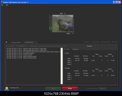

    The first screen shot shows the sound bars and also all my other settings.

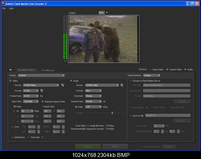

    The second screen shot shows the second error message I mentioned.

    First screen shot
Name:	1st screen shot - FME preview pane.bmp
    Second screen shot
Name:	2nd screen shot - FME audio error.bmp
