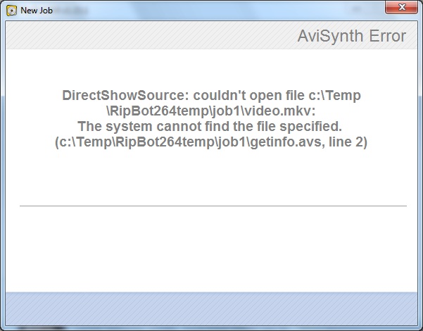

    I am using RipBot264 and usually it works perfectly.
    Ever since I upgraded to RipBot264 v1.15.1 there are some movies that the program has difficulties to demux.
    Usually using RipBot264 v1.15.0 solves it and between the 2 of them I manage to convert most of my titles.
    There is one title that gives me the error below.
    I am using AnyDVD in order to copy the entire Blu Ray content to my HD.
    I tried using other computers as well yet no good. It seems to be this title (so far).
    Any idea what can cause it?
    Thank you very much.

    You could try use clown_bd to make a new ts file from the blu-ray folder and then convert the ts using ripbot264.
  3. Thanks... It worked.
    I did as you said and v1.15.1 gave me an error.
    I switched back to version v1.15.0 and it worked.
    I couldn't use the True HD in the rip.
    I had to point it to the sound file manually and it recognized only the AC3 file.
    Still, it worked... So thank you very much!
