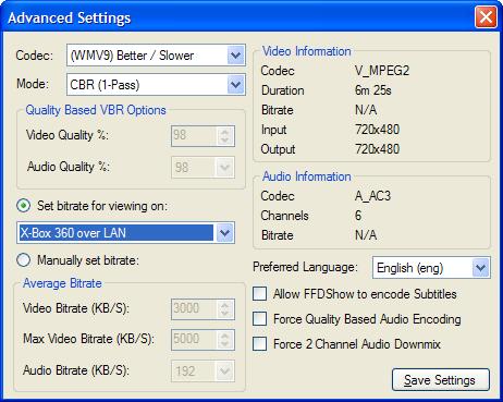

    My experience was converting hd-dvd to wmv with 5.1. I had searched the forum and there was a post on a successful mkv to wmv conversion with 5.1.
    Please note in encode360 it defaults to downmix 5.1 in the advance settings. You'll need to deselect it in advanced settings.

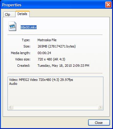

    I ripped a track off a dvd that had 5.1. This will be a standard def converion - you did not mention whether or not it was a high def mkv.
    I then used makemkv to get a mkv with 5.1 ac3 from the ripped vob. I am now using format factory to convert to wmv. In the settings you have to manipulate it to select 6 channel 5.1 audio and change the frequency to 48khz.
    I will copy this to a memory stick and test it on my 360 to see if the 5.1 is retained. If so this will work.
    Edit 2 - for some reason I can read the mkv file i made and import it into format factory but it says "fail to decode" when it starts the conversion.
    I'll see if I can make a mkv with another program and try again.
    Edit 3 - Hey encode360 is taking the mkv file I made with makemkv! I made sure it was set to keep the 5.1 audio (the original ac3 audio). Hopefully it will convert it to wma audio 5.1. If not I don't know if ac3 inside wmv will work on the 360. It should theoretically since it supports ac3 in dvd and divx/xvid.
    I'll let you know when its done converting.

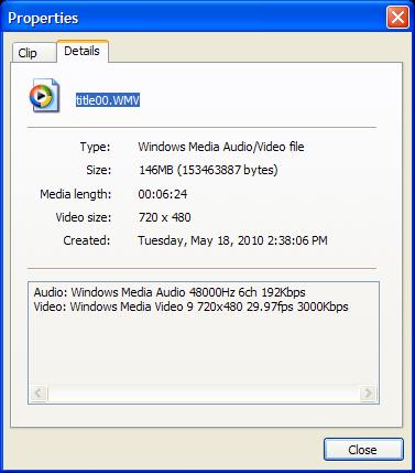

    Edit 4 - It worked! Here are the confirmations. Like I said I first ripped a chapter out of a dvd with 5.1 ac3 (dts may be a complication). I then used makemkv to make an mkv. Then opened that mkv with encode360. I selected 720x480 and made sure it retained 5.1 in the advanced settings. THan after it encoded I got a wmv with 5.1 audio. I played it on my xbox and it worked perfectly! No synch issues. I also got the full blue light on my sony amp indicating the full 5.1 audio.
    Here are the screen grabs - all from media player classic - for some reason it did not report the ac3 5.1 audio in the mkv file.
    Please note this was a straight sd dvd conversion with ac3 audio. It does allow output of up to 1080p. As mentioned I haven't tested this with dts audio. I have also not done a straight conversion with dolby true hd or dts master audio (or uncompressed multichannel pcm audio for that matter).
    If it chokes on hd audio you'll need to convert with eac3to or some other conversion program to downconvert to sd audio. I don't know if you can go higher than 192kpbs audio. But remember this is wma bitrate language not ac3 so the scale is different but it is definitely 5.1 audio.

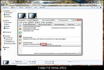

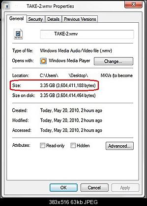

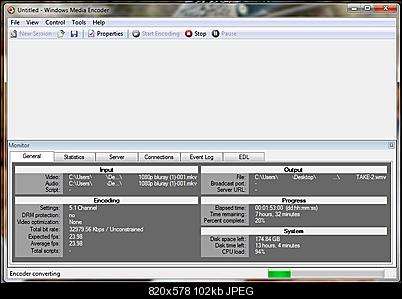

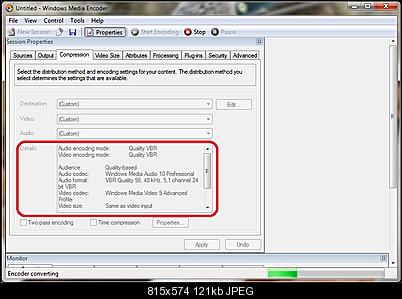

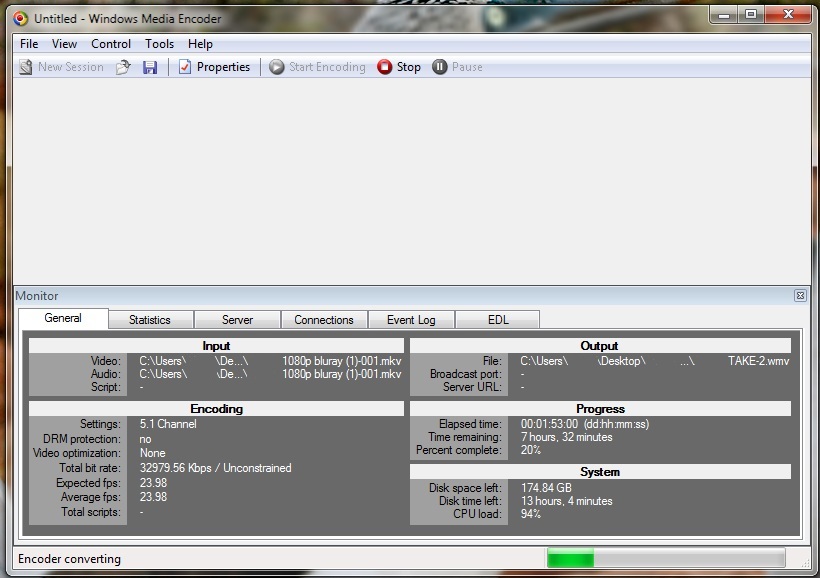

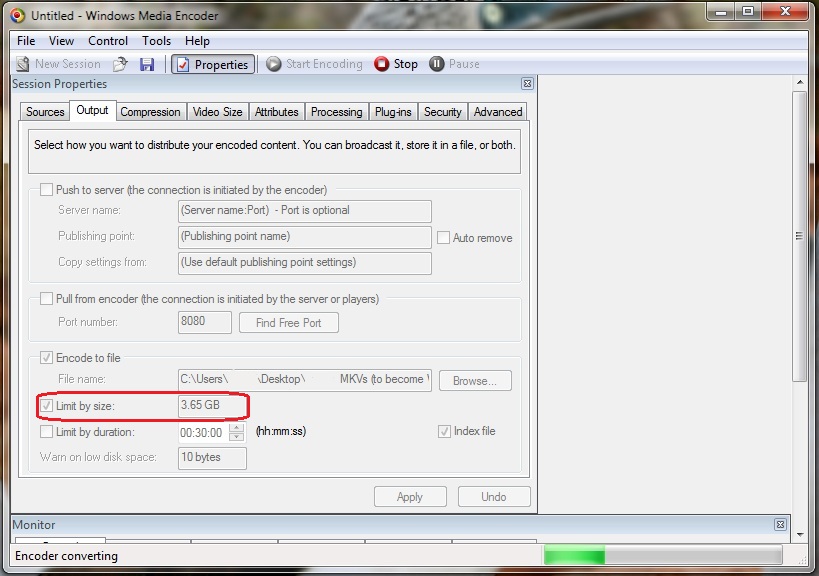

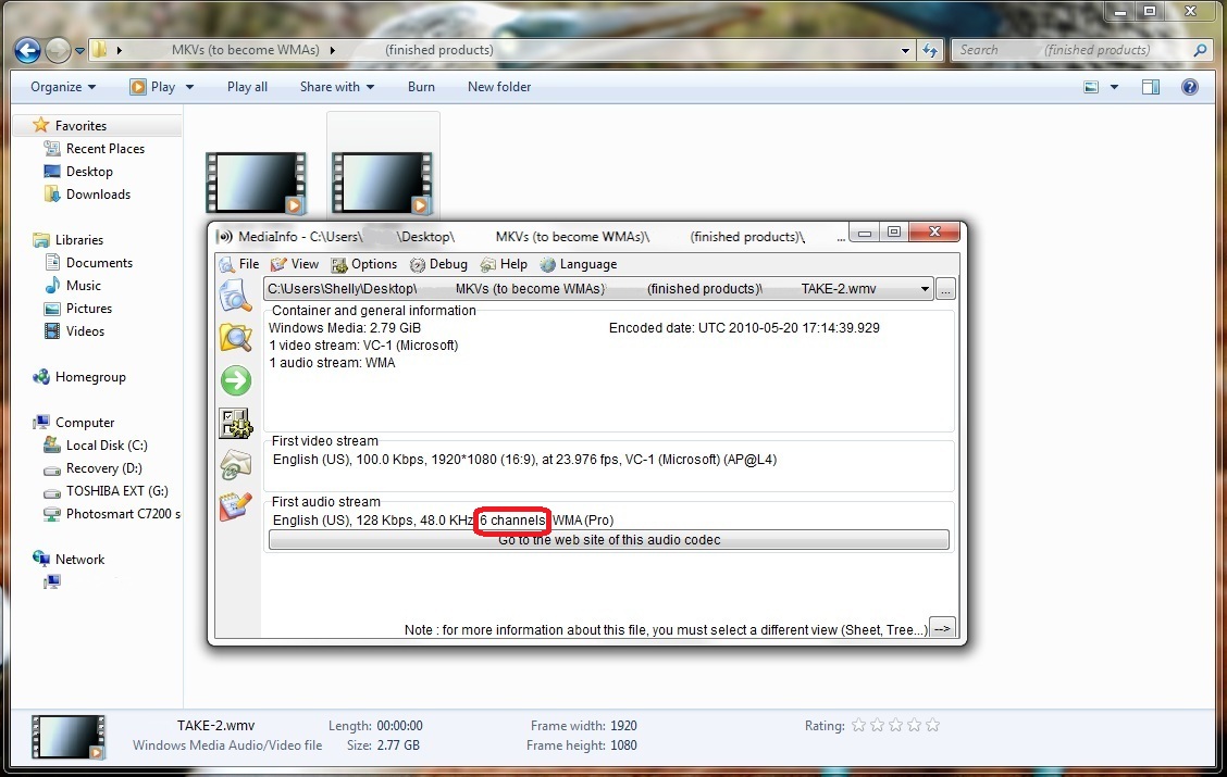

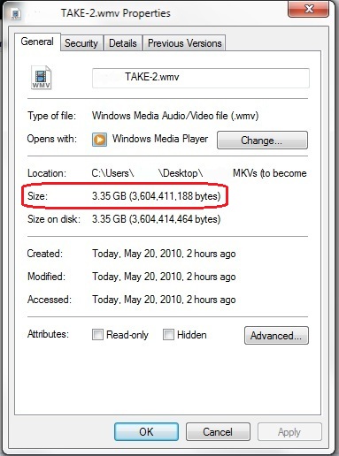

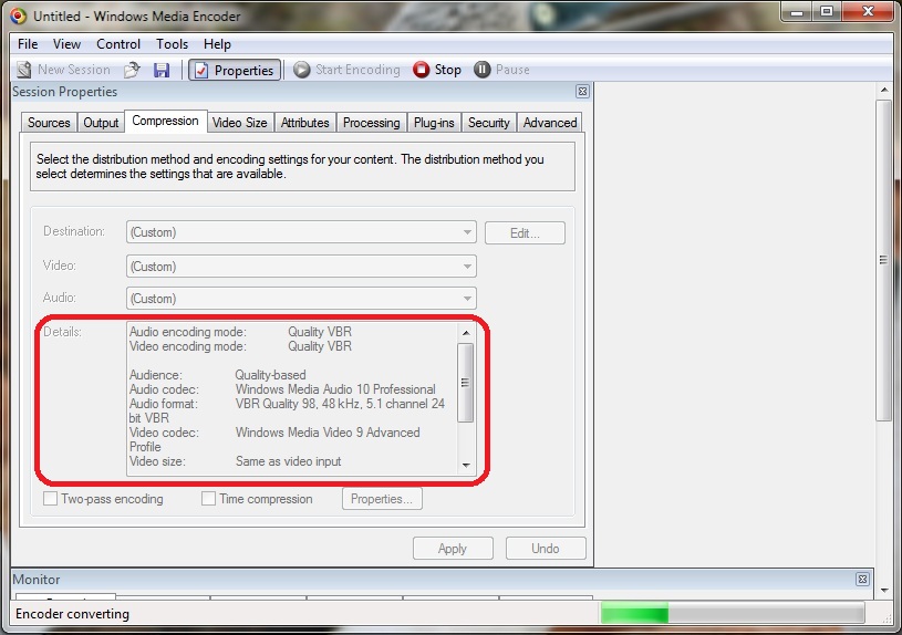

  13. Member Spdngblt56's Avatar
    May 2010
    Here & There
    @Yoda,
    Yeah encode360 seems to start up and recognize the mkv just fine... the problem is that it gets hanged up when trying to encode and stays in a "pre processing" mode the whole time. I noticed that it did start to make the wmv file --> but only amounted to about ~5 kb before quitting.
    Ironically, the same thing happened when I was using certain settings on Windows Media Encoder... the first time I tried it, it only resulted in the same sized (~5kb) wmv file before quitting.
    Then I changed some settings around and gave it another go... and It worked! -->EXCEPT the file was over 11GB when done (even though the input file was only ~3.6GB) ?? So I figured the best thing would be to keep those setting but just change the "output format" to limit the file size at 3650Mb... however... it still has about 7hrs to go, and already its at 2.77GB... so i'm guessing that didn't work??
    Either way though... its better than no progress at all --> perhaps if I could only figure out now how to limit my file size correctly, I would be able to get the seetings just right! Here are some pics about the things i've mentioned so far:Click image for larger version

    Unfortunately... as you all can see in the picture just above this the file is 3.35GB (once the file reached this size the encoding stopped, and now i'm missing half of the movie!
    I think I have to edit the bitrate somehow, instead of limiting the output file size so that I get a correct ~4GB WMV... rather than simply getting a 3.35GB file with only half of the movie on it, all because the program stopped encoding once it reached that file size.

    Well I'm glad wme is at least encoding.
    You know in that one pic you posted it did show windows media audio 10 in there. THat must have been where I got that idea on needing it for 5.1 wma audio. However it is only 9.2 or something in encode360 but I can get 5.1 wma out of encode360.
    Here's hoping you get it going this time.
    It might be worth a test on xp just to see if encode360 does behave differently for you. Just be sure you have wme installed also (though I guess the virtual machine should have access to both??).

    <<>> EDIT: There is some added info in my last post along with *updated* pictures (things circled in red)
    I'm almost there...
    I just need to figure out what I need to set the bitrate of the encoder to be so that I get the fully encoded movie --> but in a normal 4GB file rather than 11GB!
    Thanks to everyone for helping me through this!
    <<>> EDIT 2: I found an awesome bitrate calculator on our own videohelp.com! I put in all the info about my MKV, and it popped out an awesome bitrate for me --> I just copy and pasted it into my encoder...
    I'll let you all know tomorrow whether it worked or not (keeping my fingers crossed)
    <<>> EDIT 3: IT WORKED!!!! I finally did it.... All of the 3 MKVs files I had were successfully converted to WMVs with NO LOSS of quality or audio
    As a matter of fact, the outcome was quite amazing... once I used the bitrate calculator to figure out how to limit the file sizes so that they wouldn't be over 4GB, that is.
