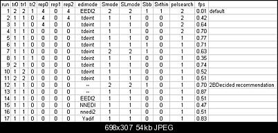

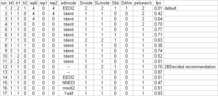

    The following fps numbers are for a dual core laptop, so a quad core desktop should be quite a bit faster.
    edit: Forgot to mention that I updated my TGMC script to use tdeint instead of Yadif for the deinterlacer. This is mainly because I use the 64bit avisynth at home and Yadif wasn't recompiled for 64bit environement yet. The results between Yadif and tdeint are very similar. Also note, that case sensitivity is important with edimode in TGMC. Look through the script and use the edimode exactly as written there (EEDI2 rather than eedi2), otherwise it will default to using bicubic for the edimode (same as "--").
    Commentary post runs:
    You can see that there is a very large difference in conversion rate between the default settings and some of the reduced sets. The biggest knobs in performance seem to be MDegrain temporal filtering and repair (3rd and 6th number in the parameter strings), the temporal radius for the temporal gauss after motion compensation (2nd number) and the edimode.
    This is what I can gleam from reading through the TGMC thread on doom9 (called "exist any filter specially done for (deinterlace) flicker") and reading through the script itself
    **anyone that knows better please correct me where I go astray**
    - the first 3 parameters (defaults @ 2,2,1) set the temporal gauss filtering for the script. These are responsible for the reduction/elimination of the flicker/bob shimmer. Some sources will need more or less filtering to reduce the shimmer.
    - the next 3 parameters (defaults @ 4,0,4) are the repair parameters used to combat artifacting
    - edimode sets which program/plugin is used for interpolating the missing pixels. I don't know what each one brings to the table as strength/weakness compared to see each. I have read that EEDI2, NNEDI, and nnedi2 are better at connecting up straight lines whereas bicubic and Yadif (and tdeint) are much faster.
    - Smode sets the method used for re-sharpening the motion compensated temporal gauss
    - SLmode sets the method used to limit the re-sharpening
    - Sbb is defined as the back-blending of the gauss-blurred sharpen difference (this sounds like another way to limit the sharpening???)
    - SVthin can be set to thin out horizontal edges that are broadened with the interpolation
    - pelsearch can be toggled between 1 (fast) and 2 (accurate). This defines the running of the motion vector tools.
    P.S. There are main more parameters that can be toggled in the script, these are just the ones that I chose to play with.

    I updated the post above with the finished table to show TGMC speed in fps (on a dual core laptop) for a 1080i video encoded with x264 (1080i --> 720p run through srestore to restore PAL framerate) for various setting changes.
