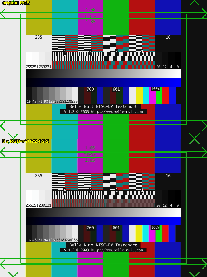

    But they really do accumulate with rounding errors. Going in/out of your NLE multiple times isn't a good idea
    Here is an illustrative example of 3 rounds of RGB=>YUY2 (and back to RGB for the screenshot) conversions. Make sure you look at full size, or even zoom in. Look closely at the lines in between colors. This was "lossless" compression, so compression losses would be additive to this . Now on live action or "normal" material it should be less visible to the naked eye than a test partter, but it's still better to avoid colorspace conversions
Name:	3 x RGB to YUY2 422.png
