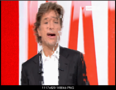

    StaxRip encoding directly. ts, sometimes on some TS encoding crashes (even after a passage on TSdoctor,
    So I thought may be creating a dga, dga I create via dgindexdga and there it shows me an error: "Found NALU type 13, lens 46 undefined, Ignoring NALU, moving on" something like that so I is canceled for its repair, and therefore start from the sava So here is the video demuxer at .264 and with the encoding happens here niquel not lock! My good q'un misfortunes never seen one here is the result after encoding on the contour of moving object =>

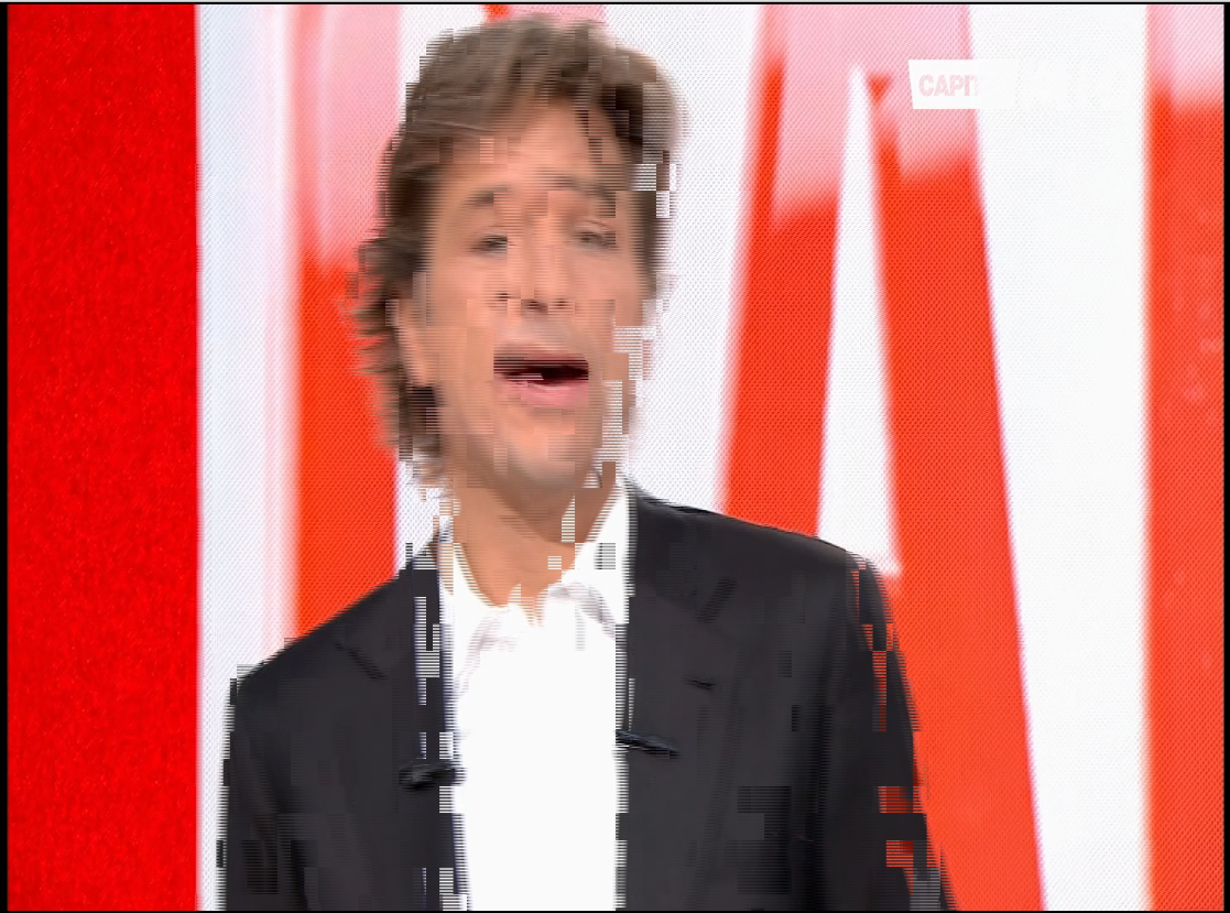

    donc je me suis dit peut etre crée un dga , je crée le dga via dgindexdga et là il m'indique une erreur : "Found NALU type 13, lens 46 undefined, ignoring NALU, moving on" un truc comme çà donc je fait annulé pour que sa répare , et donc a partir de la sava donc là la video est demuxer en .264 et avec çà l'encodage passe niquel pas de blocage ! mes bon vu q'un malheur n'arrive jamais seul voici le resultat apres encodage sur le contour d'objet qui bouge =>

  2. Those block decoding errors are well know bug with dgavcindex and interlaced streams. This has been addressed in many threads. It is based on an old libavcodec libary that the author requires for frame accurate access. Directshowsource + new version of ffdshow, or divx h.264 decoder should decode those streams without the pixellation
    Sync issues are usually from drop outs or bad streams with errors. Very Difficult to fix without processing in segments
