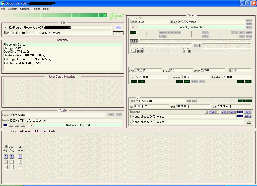

    I was wondering if this a true dv-avi capture. I used virtual vcr because my fusion hdtv gold t 3 capture card is a wdm driver card and won't show up properly in virtualdub.
    The drivers provided with the card do not offer direct avi recording (similar to the hauppauge 250,350 series - hardware mpeg encoding card with hdtv tuner).
    Here are the stats via gspot:
    [img]dvtest.JPG[/img]
    So is the correct? I used the panasonic dvsd codec. This is from a vhs capture over svideo output from a panasonic dmres46v vhs-dvd recorder player combo unit.

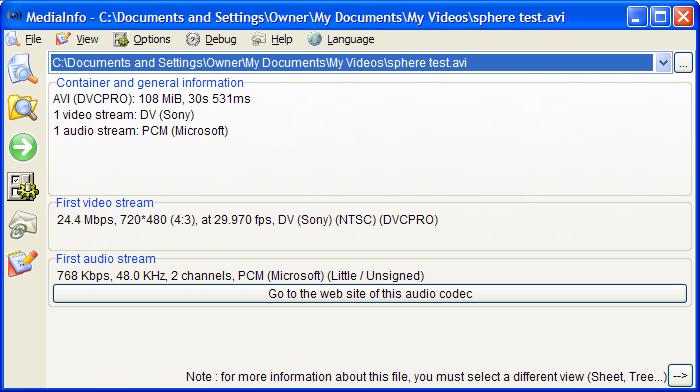

    pcm is not compressed so you should use the standard ~1500kbps 48khtz setting. it looks like it's DVavi. check with mediainfo and see if the video bitrate is ~25000kbps.
  3. Member yoda313's Avatar
    Jun 2004
    The Animus
    Yes it does have that bitrate - here:
    Actually I have since downloaded ac3acmdecompressor so I can encode to ac3 directly. However for some reason I can only encode to 192kpbs in virtualvcr. It does not let me record at 384kpbs or 448kpbs. Is this a limit of the encoder or a virtualvcr limit?
